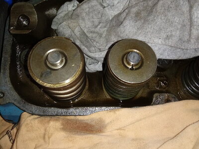

I got these new valve springs from 440 source,> http://store.440source.com/Stealth-Cylinder-Head-Valve-Springs-Set-of-16/productinfo/200-1058/
They are a little bigger than my old stock ones. I put a new spring on the left in the pic, the one on the right is stock. Are the stock keeper/caps going to work?
Replace the stock retainers and locks its cheap insurance!
The exhaust valve keepers generally touch one another so the valve rotates in them. Supposably helps with not creating carbon deposits in the valve seats. The intake valve keepers will have a gap between each other.
You'll see a slight difference with installed height between the two because of this.
Most on here will tell your to replace the retainers and keepers with larger ones and clips.
I ran across the same thing with my new crane springs, I installed the original retainers and keepers and have aprox 4,000 miles on them and quite a few 5,000 rpm pulls on them. Has not been a problem on mine.
Couple weeks later after install I pulled one cover just to look. The springs and hardware were right were I left them.
With the retainer making contact all around the spring, and the keepers/locks fitting the valve stems plus the spring base is sitting flush to the head I was ok with it.
Make sure to ck. Install height and ck. For coil bind.
Is the i.d. of the new spring the same as the i.d. step on the keeper to keep the spring from walking around?
Stock application or modified?
Check for contact with the rocker arm
It’s not ideal, but it’ll work okay.
Looks like those originals are the low perf springs?(no damper inside)
The original red HP springs didn’t fit the retainers very well either.
It is a tad bigger but the stock ones had a little wiggle room as well. I think everything was stock on this motor. I'm going for it! Seems ok to me. This motor is no hi dollar investment so no big deal if if blows.
Here’s a spring & retainer off a MP crate Hemi.
Retainer step OD- .980”
Spring ID- 1.125”
.145” of slop on a factory assembled head.
The stock 440 retainer step is about 1.00”, and a stock HP spring ID is about 1.070”.
The spring I usually use with stock retainers has an ID of 1.086”, so slightly more slop than what you’d have with the factory HP spring, but still vastly better than what came on a crate Hemi.
