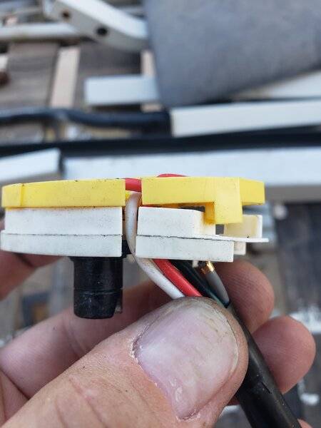

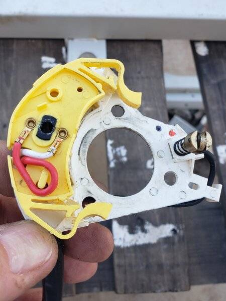

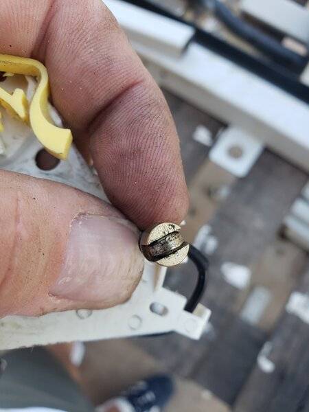

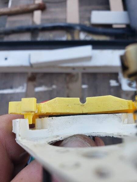

Fast forward to 2 months ago when turning right the signal would then switch to left turn after the turn was complete. So I finally dug into it and found the switch is cracked and pulling apart so the arms are pulling away. Also, the roller contact for the horn was rotating due to a bad crimp. Probably not a great contact. I can't recommend it. I hate wasting time switching out a part for something inferior.

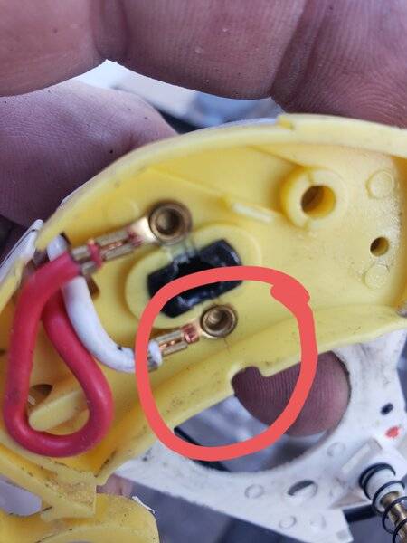

I circled the crack below.
Definitely looks like a junk piece.

Looks like you may have overtightened the turn signal lever screw, judging from the location of the crack.
It would have no bearing on a crack developing because the lever screw holds the signal stalk to the pivot stud (it is metal) and nothing more. It doesn't tighten or hold the top signal portion (yellow piece). The yellow piece is noticeably thinner than the original.
Brings up another issue with the pivot. On the turn signal stalk there is a v ridge that goes into the v notch on the part. Well the v notch was too narrow and had to be filed on for the v to actually engage.
