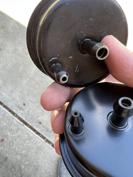

I got my lines from inline tube and my separator from 521 restorations (jsbrown1 on eBay). From what I can tell, 521 part is the correct opening size. I have not measured it, but it looked correct when I got it.
Here is the difference. The pointy one has the correct size of .060. The top one has the huge hole that will lower your fuel pressure. I believe Mopar Mall is where I ordered one and it had the correct size.
