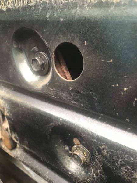

Seems like what I am up against.
Great ideas here to get back to trying with though, thanks everyone. I'll hit it when I can and see where I can get to.
YEP... a few turns to loosen and the assembly slides up in one piece.

I’ve had them be off from the access hole just like your problem. Cut an Allen wrench short enough to go in behind the door and insert in the Allen bolt straight on.

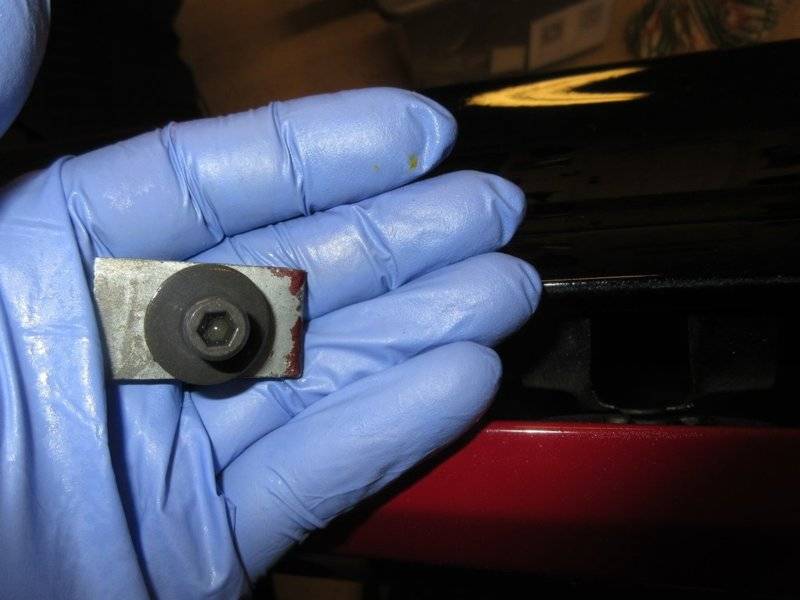

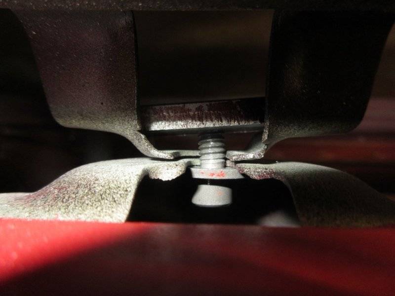

Photo of the Allen bolt that doesn’t exist. LOL
I also didn't have to edit my post to include a picture, 23 mins after my post showing the correct part:D
OK shame on me for going out to the garage and taking a picture to show people what the darn thing looks like. More and more I get grief for posting a photo of parts to help people, and it’s always rom a 3rd party, WHY IS THAT??? The original person asking the question is usually happy, as in this case.

When I read his first post I knew what the part and problem was because I’ve been there before.
You had a restoration thread and had a photo of the part in your hand, but the first thing you did is call him out say there ain’t no Allen head bolts, blah, blah, blah.

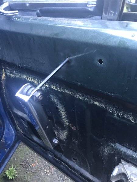

What I did on my 68 Charger. I used a uni bit and made the hole bigger, then drilled the head of the bolt off.
65F8710A-7DCF-4CA1-89BA-AB1D91F2A49B.jpeg 010F69CD-3EDD-4287-A5FF-5125BFB9EE6F.jpeg
