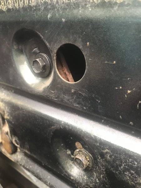

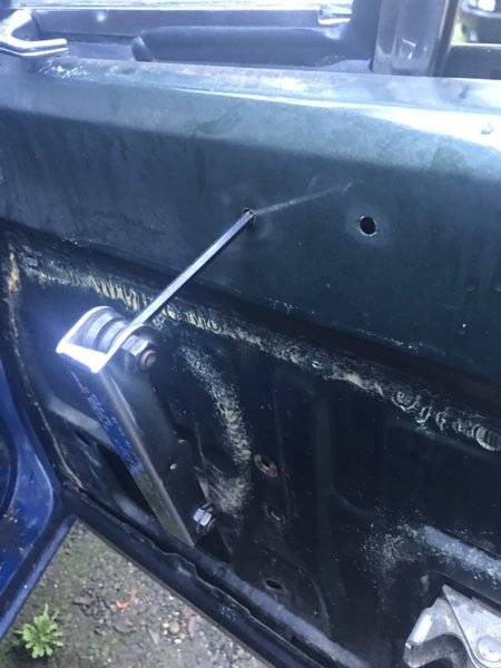

If you can get a drill/impact bit with the ball end on it....that may be your best bet. ...as long as you haven't already stripped the allen drive. Those impact driver drills are pretty amazing on what they can break loose. If you are looking at drilling it.....at least make sure you've thoroughly stripped the allen drive before you give up on the allen wrench.
I've had similar issues where they were slightly off from the hole in the door. Maybe when they installed them from the factory the bolt "walked" a little during the final tighten. I was always successful in driving an allen wrench onto the bolt and using a crescent wrench to break it loose. That was before I had an impact driver available. Those buggers can be tight...I always cringed as I was adding more and more pressure to loosen and then usually "pop" it breaks loose and then it's easy to loosen.
That's fine on a Charger because it's got an upper door panel pad to hide the extra drilling, but not so on a GTX.
Thanks for clearing that up, for me. I couldn't figger where he was drilling the bigger hole. Picture didn't look like my 68 Satty.......MO

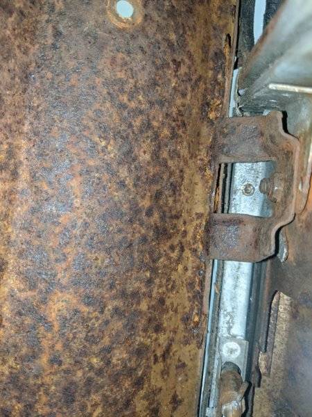

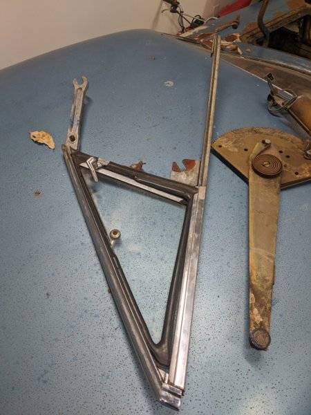

I finally got back to the window and got it out.
Yes I stripped the Allen key and it has a nut on the back not a square type washer.
Luckily I was able to loosen it slightly which was enough to would it out.
