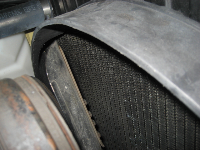

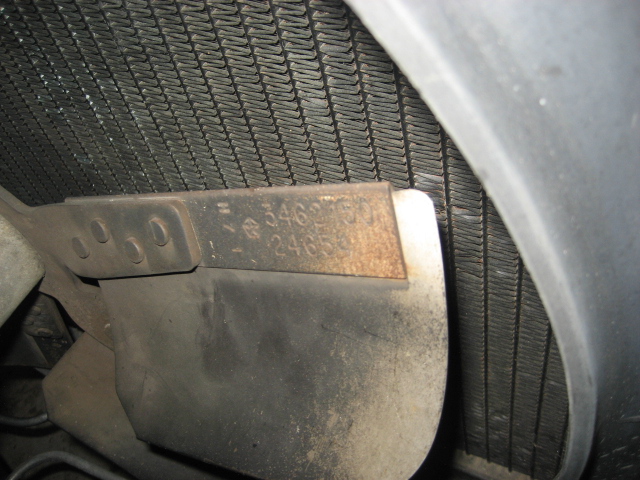

On my 72 Coronet from fan tip to fan tip it's about 18 inches. I have a 26 inch stock Radiator with stock replacement Shroud
Cool, yeah, my fan is a little larger diameter. How much clearance is there around your fan?

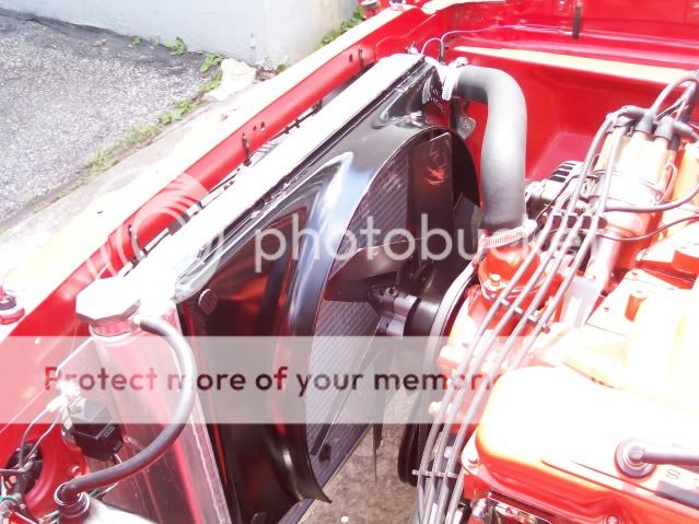

Here is the Summit shroud, mine is not a clutch fan but is an 18" flex, the opening is 20" and works great. bolted right up. 440 26" SB radiator.
