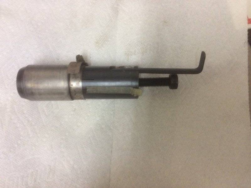

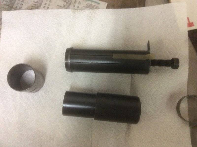

Nothing wrong with what Creedog said but me being a lazy f--k I bought the tool. Use hose clamp to make it easier to put tool in trans. Opened after in trans. That piece sticking out is pushed in fully before pulling bushing. There is a ring in ID to keep tool from collapsing when pulling bushing.

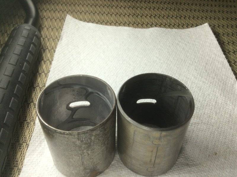

As Creedog said bushing position is important for lubrication. Halfway out I marked the bottom so I could tell how new one should go. Note lube hole. New on left.
