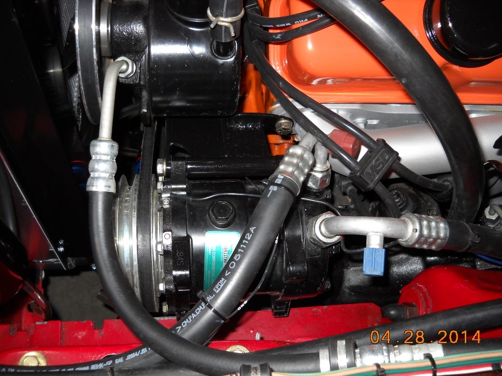

Vintage Air does not offer a "AC kit" for our year Mopars, but that doesn't mean you can't make one work. We are in central Texas and our summers are quite hot so AC is a must, however I'm building a Street Wedge recreation and having a big honking compressor with all the associated AC lines running all over the place is NOT what I want.
So I located a compressor mount that sticks it down where the power steering unit would normally go. That solved one problem. It will also allow me to run the lines out under the battery tray to the condenser and drier. They will then travel through the passengers wheel well into the air box and from there into the car. So no AC lines all over in the engine compartment.

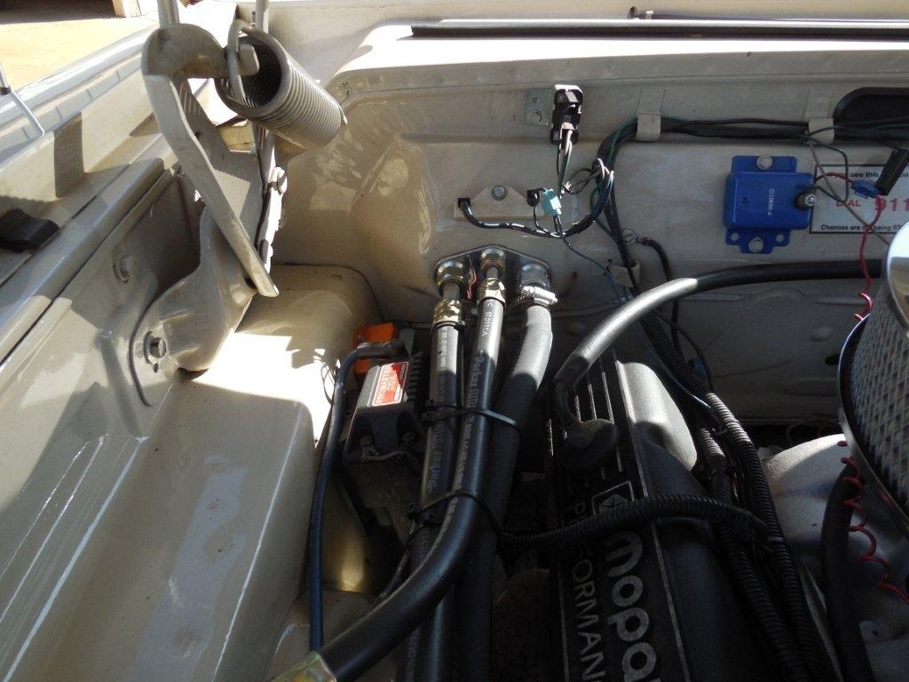

Good plan. That's exactly how I did the hemi-wagon.....and it worked and looked good. I passed the lines thru the top of the rt-inner with some billet bulkhead connectors and AN, for a little bling. I also passed them thru the cowl-side, to keep them outta the engine-bay.

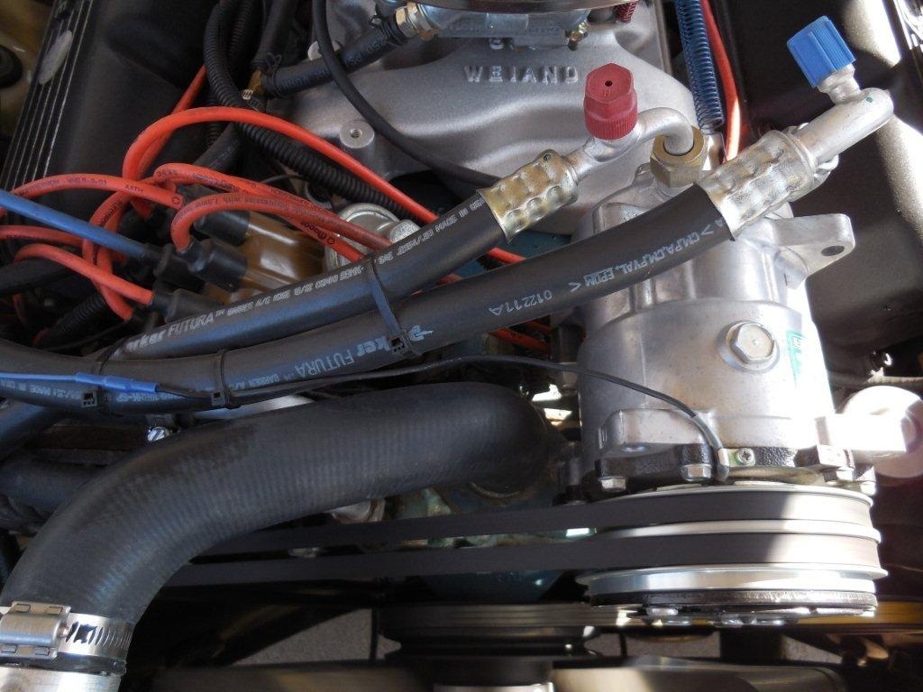

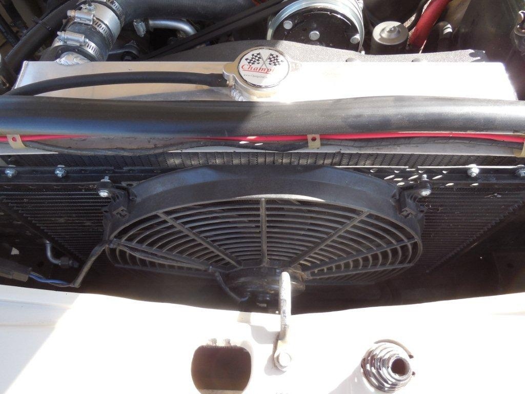

Looks like you bought the same unit as me, 32 degrees out of the vents:thumbsup:. I hard plumbed as many lines as I could and kept it nice and neat with a low mount A/C serpentine setup, very happy with it.

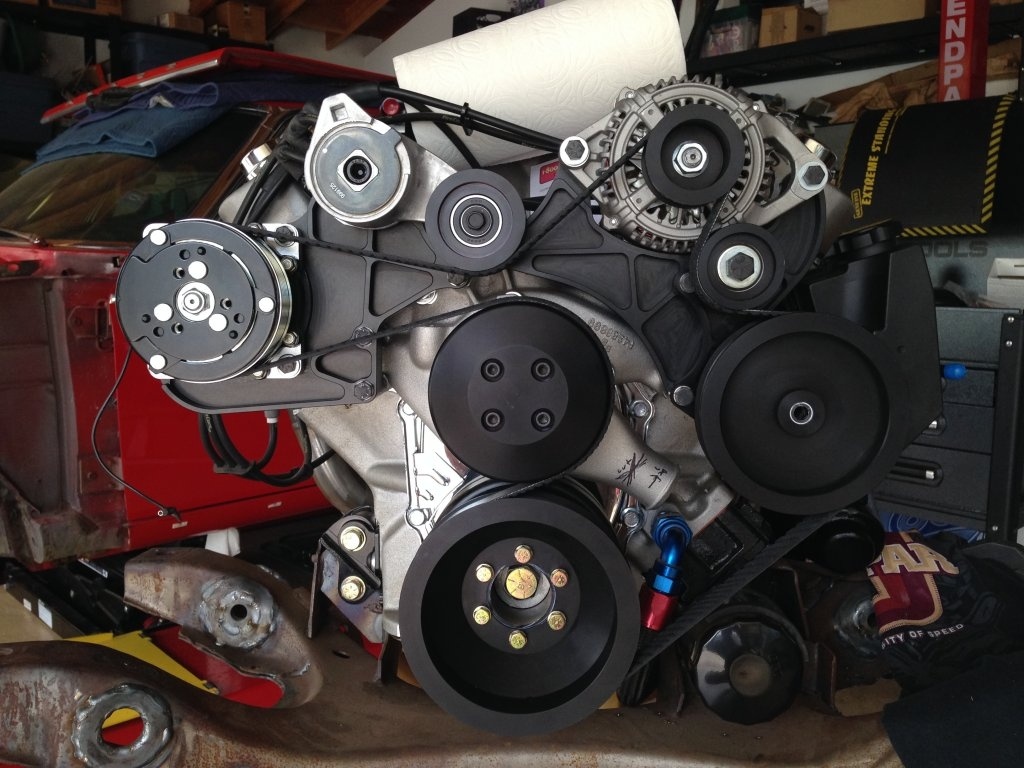

You are doing what I plan for my 65 other than I'll be doing the pass through behind the rh fender to bring the lines in. My unit is getting replaced since I'm using a 70 k-frame which move the engine back [interferance with the h valve], heater core leaks and the blower fried. I like the newer units since they do away with the vacuum pods and are more efficient. Are you using the big unit or the next one down? I solved my compressor mounting with the serp setup from SD Concepts.

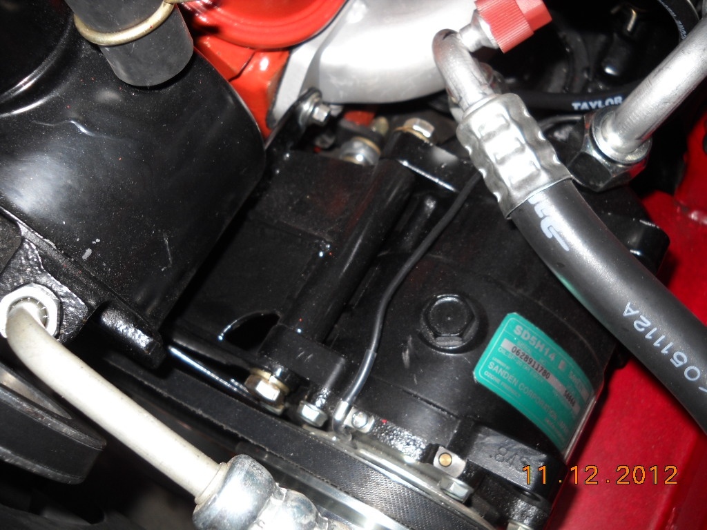

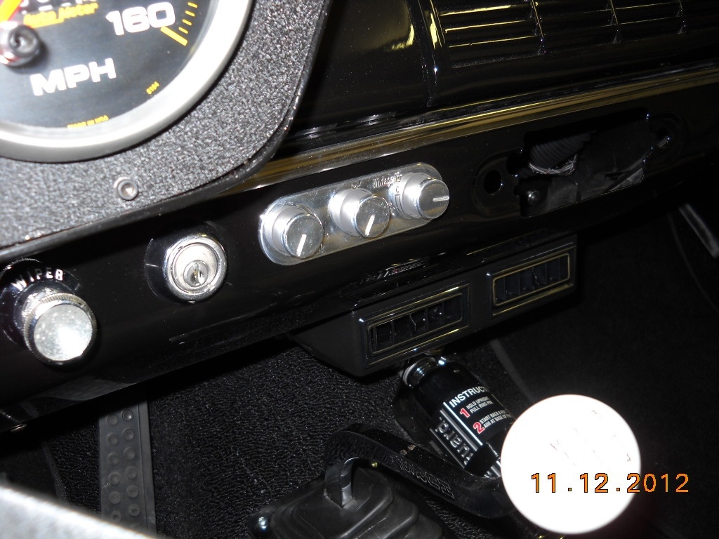

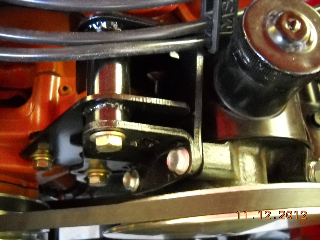

Yes, dagoldguy, it has been done before. Vintage Air compressor mounted on a custom bracket that moves the P/S pump up a few inches. Custom fab that turned my March billet dual belt crank pulley into a 3 belt set-up to drive the compressor. Universal under dash components. I wasn't worried about hiding anything so it was a little easier. Works like a champ...

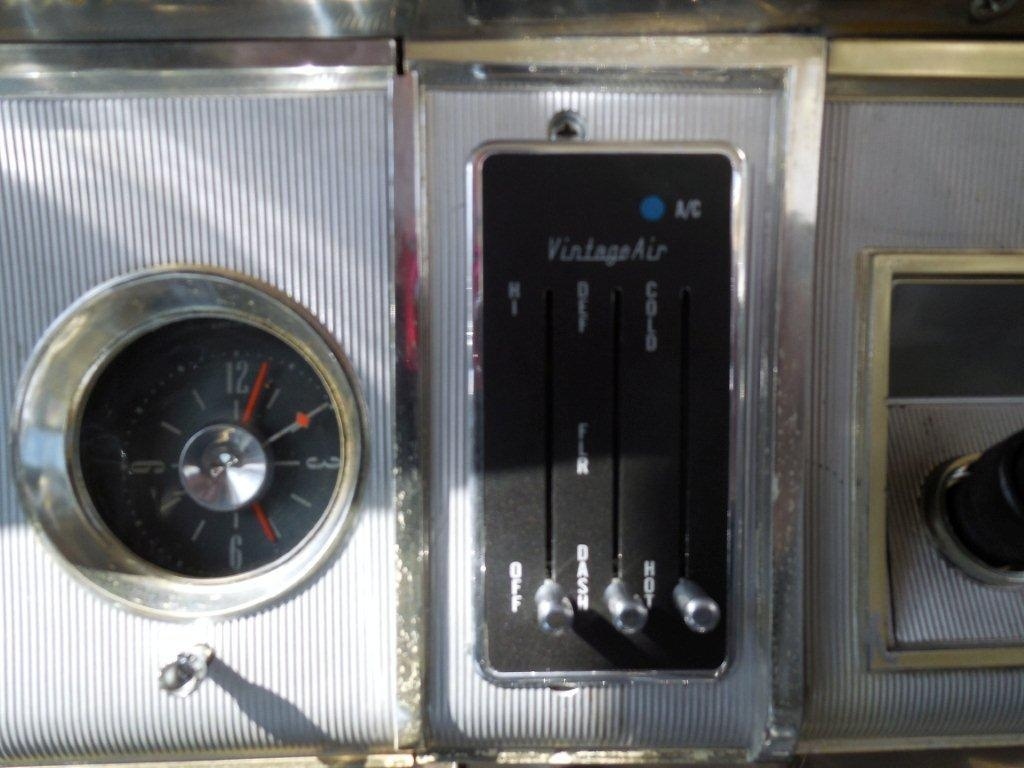

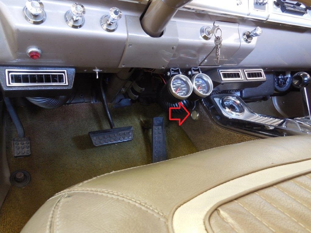

I have a Vintage Air System in my 1964 Polara 500. I will post a few generic pictures, it you guys would like something more specific let me know.
