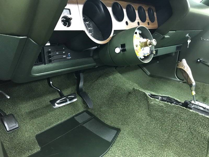

Aftermarket A/C systems can have little challenges, and sometimes you can find nicer vents and stuff. I added some A/C stuff to my friend's car, while doing the 6.4 swap. I had already added the air when it had the gen-II hemi in it. Some of the aftermarket parts can be generic and a little cheesy looking. I've done 3 A/C installs, and they all needed to be "fit" at some point. I actually liked the passenger side vent in my `cuda, better than the factory cut-outs in the OEM dash/A/C.

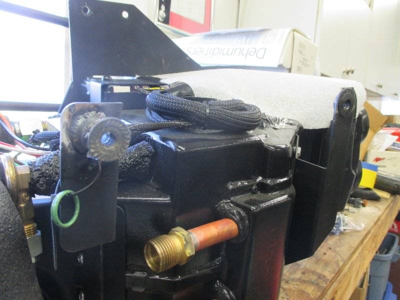

Had to weld spacers to the heater-box for a proper fit to cowl. Also had to move their suggested hole locations. All in a day's work, fabricating...

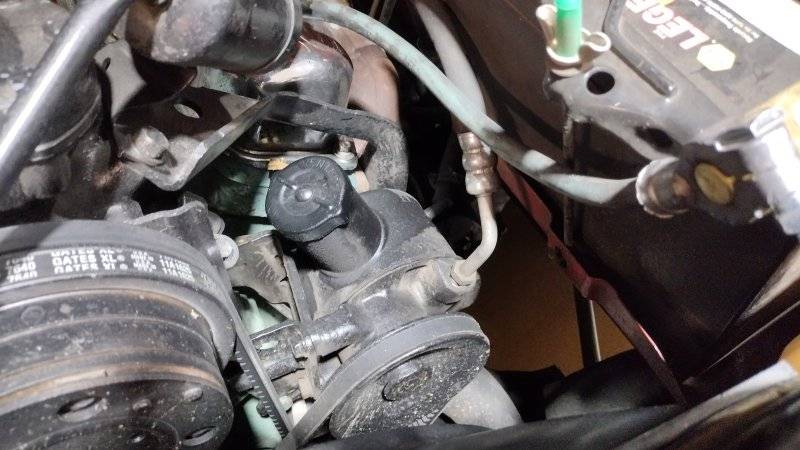

I'll post a picture of my power steering pump next. I think it is a Federal.
This is a Federal power steering pump, correct?
Guess you have to look at the back side

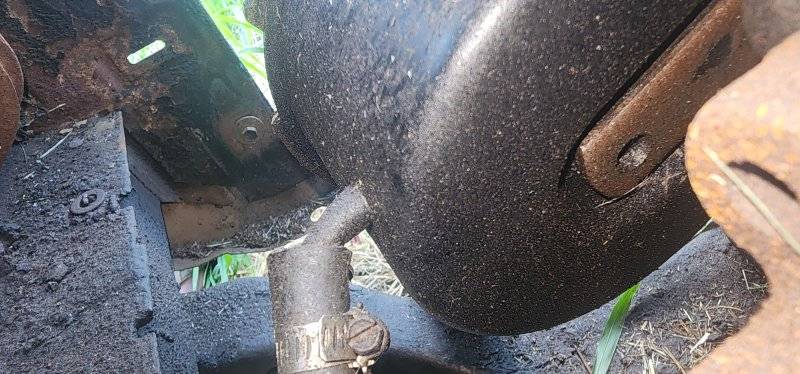

I have that same picture, BUT the backside is smooth on my pump. Also, note the high pressure connection. On both pumps it is on the rear. On my pump the high pressure line is on the front side.

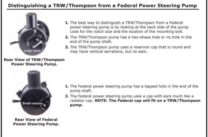

Thanks, but if you look below (copied from the Vintage Air instructions) it states the Federal Pump has a cap "much like a radiator cap". Not sure why, but it clearly says 'TRW bracket will not work with a Federal pump'.
"Does not work with Federal pump" (last sentence)
