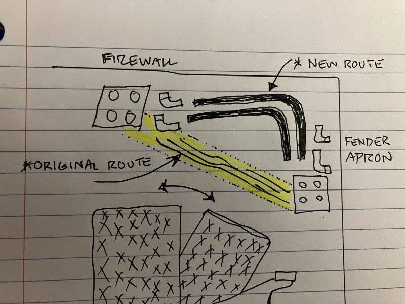

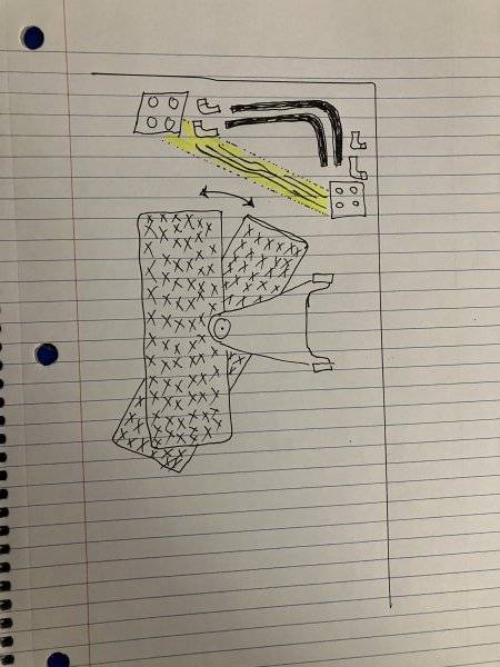

I may have come up with a way. I made this crude drawing of an overhead view.
The tire is shown straight and turning right.

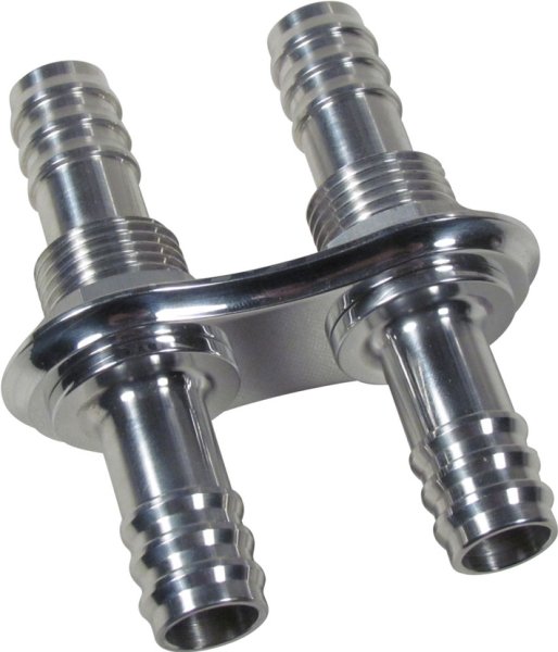

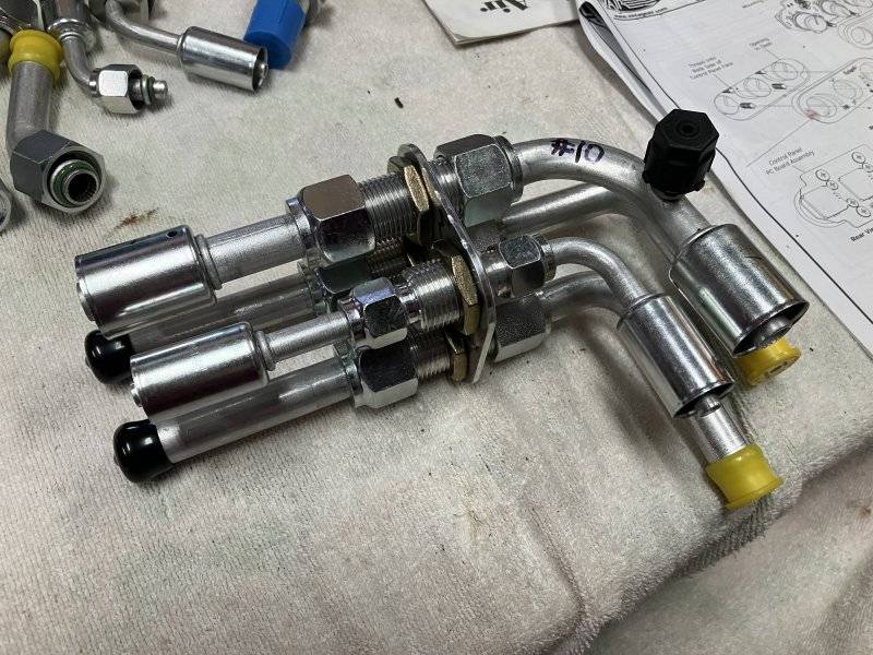

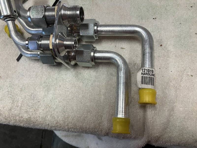

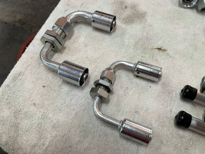

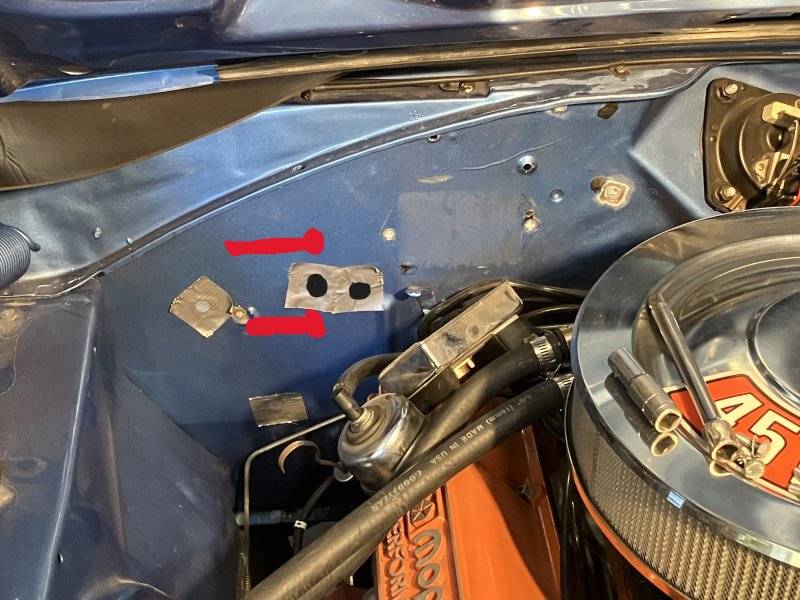

I’d first thought I’d run the lines as shown in yellow highlighter. If I get another 4 port manifold and use 90 degree fittings on all 8 ports, I might be able to keep the lines against the firewall and fender apron and out of the way of any contact with the tire.
