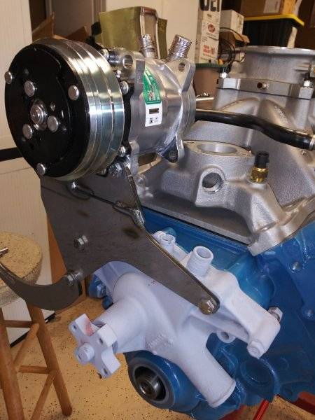

No problem. I installed a 318/390 stroker with Edelbrock Pro Flo 4 and a 904. If you go with Vintage Air I dont think they list the B Body Sure-Fit kit with a small block. I purchased through Summit Racing. Summit contacted Vintage Air to have them customize the compressor brackets for the small block Mopar. I used Altima buckets and a 2014 Chrysler 200 console. Everything went together very easily.

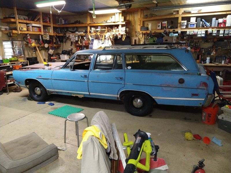

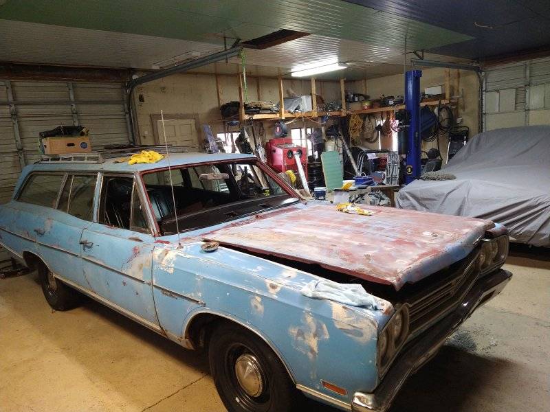

GTX that's what I'm looking for. Here's a picture of my old project
Had this about 20 years and now just getting serious on making it a good driver.

I installed Classic Auto Air in my 70 Road Runner. I modified the system to hide the compressor as much as possible. Classic Auto Air was great to work with so I could get the customized parts I needed to make it all work.

I need to read your other thread, but being that it's 44 pages (Which we appreciate all the detail), can you tell me - is the Classic Auto Air hidden Compressor bracket an off the shelf item I can order from them or was it custom? Since it's a bracket specific to our cars, do you see any reason I couldn't use this bracket in conjunction with my Vintage Air system?
