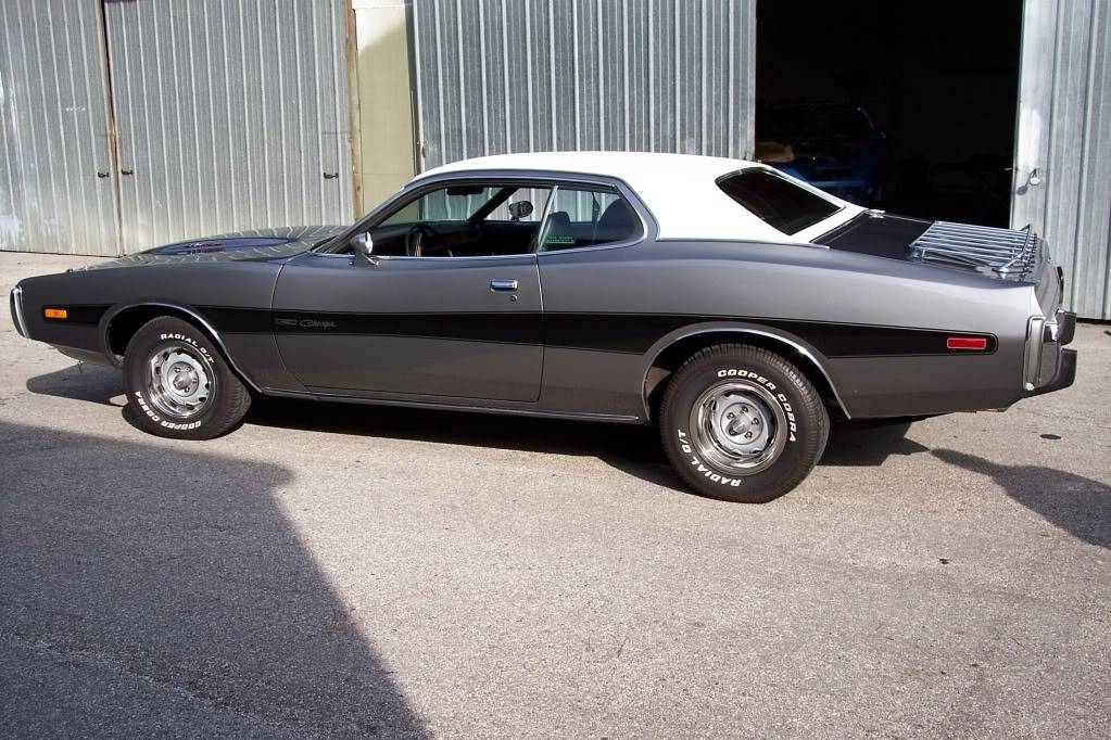

Is this an SE "opera window" roof, a half roof, or a "halo" roof?

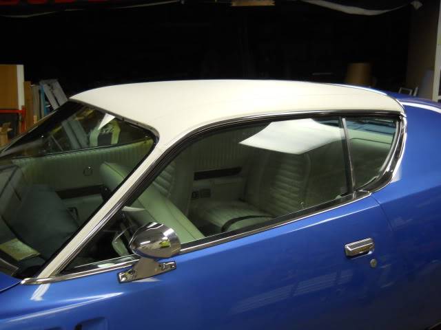

Opera roofs can be a pain because the rest of the trim is designed around the thickness of the vinyl. I personally like the SE trim around the top.
If you're just replacing the top, you can scrape the glue off. If you're painting the top, I'd use a sander, after I scrape the glue off. Either way, you should be able to scrape it off.
It's not terribly difficult to install the vinyl but I don't know how hard it is to take off your trim on the '73. I did my '71 but it's only a "canopy" (landau) roof. Best thing I can suggest is have a helper!
Sorry, it is a Rallye with full vinyl and trim all around.
