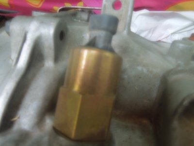

Your stock speedo will not work with a T6060. You will have to get a T56 magnum to get the speedo gear. On a T6060 it is electronic. There may be a motor that can use the electronic signal from the viper T6060 and turn your speedo or you can go aftermarket electronic speedo.
yeah hopefully i can find a speedo that will fit in my rallley dash , I'm ok with changing just the speed part if i can find one i like the looks of . Scott my buddy thats helping me said something about a box that get the signal from the sensor and then turns the cable ? but that sounds like a pain
You'll need to run an electronic speedo - also I doubt the shifter location will be anywhere you can use a stock console - with the 5-speed I put in mine I used the rear mount and modified my console to match - no one has realized it is not a factory position or factory shifter hole.

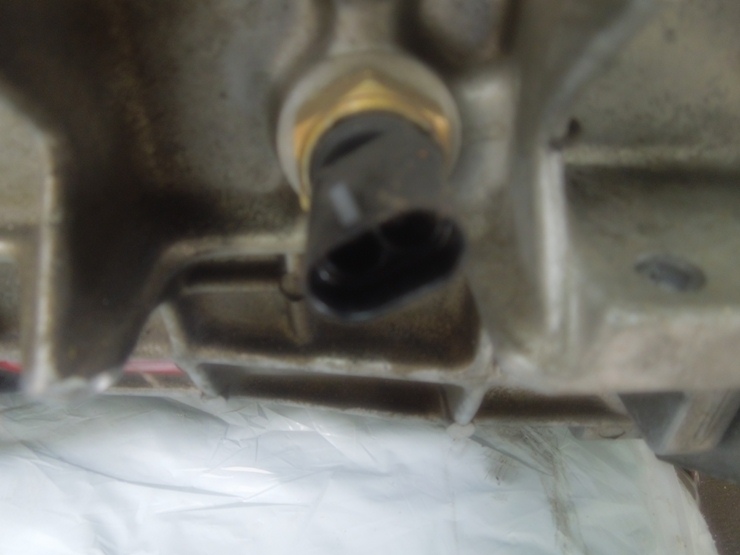

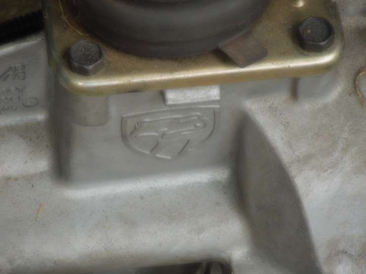

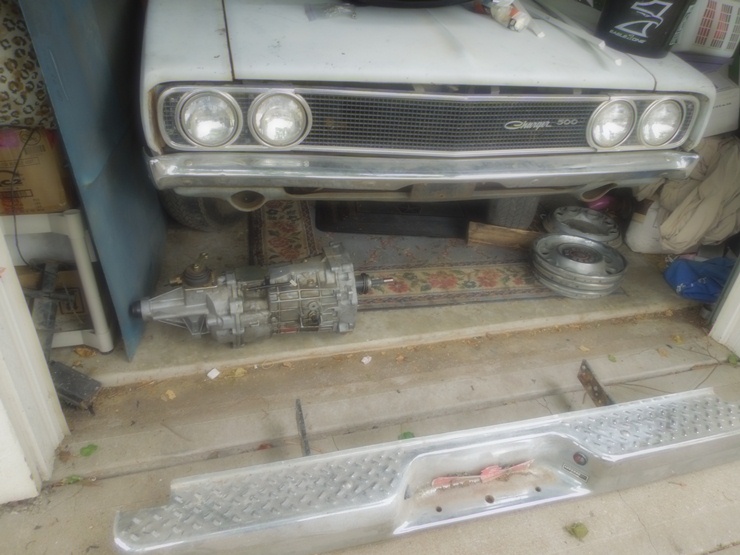

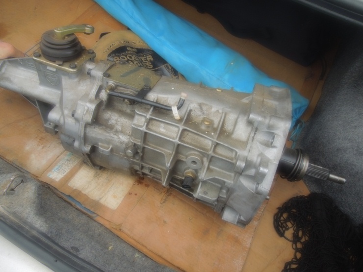

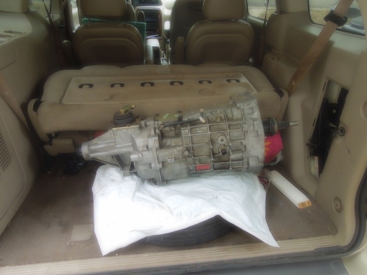

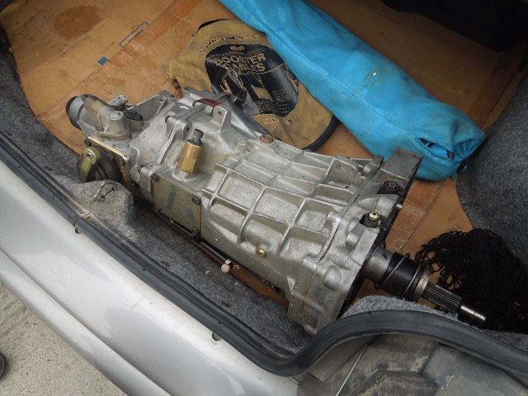

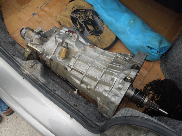

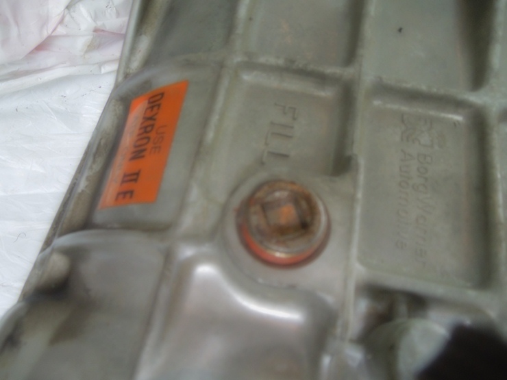

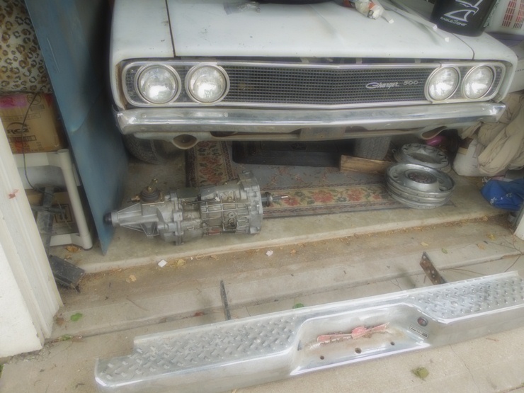

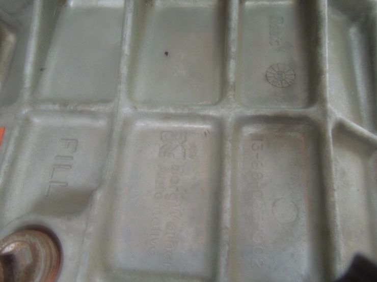

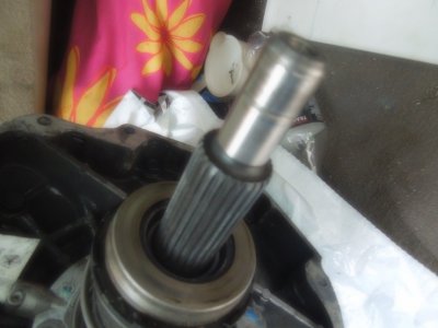

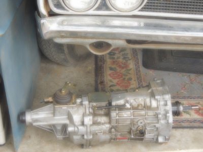

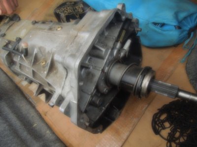

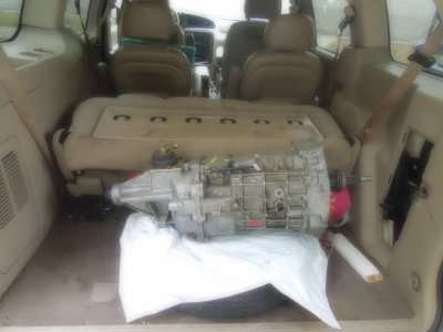

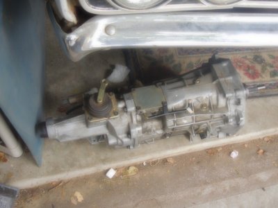

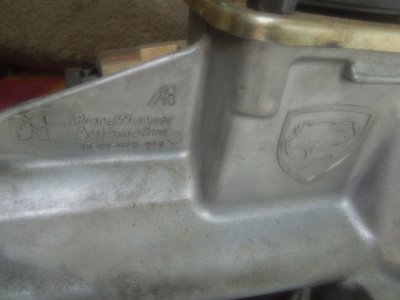

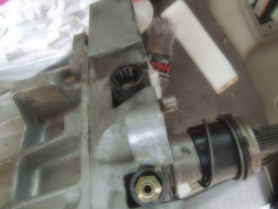

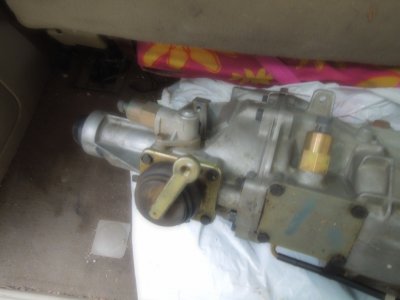

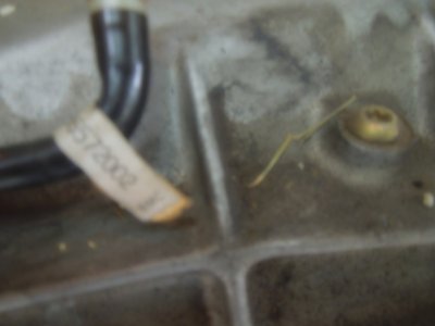

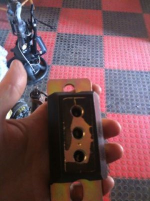

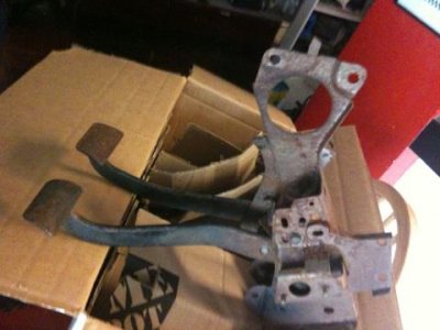

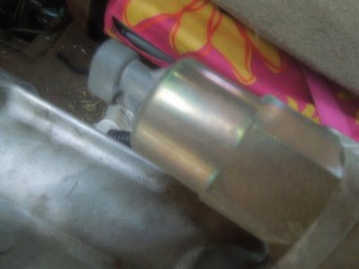

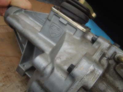

well i pulled the trigger and bought the viper tranny today

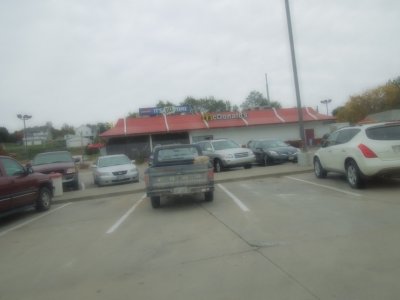

drove 1/2 way to omaha and met a guy in the mcdonalds parking lot to get the viper 6 speed
let the games begin

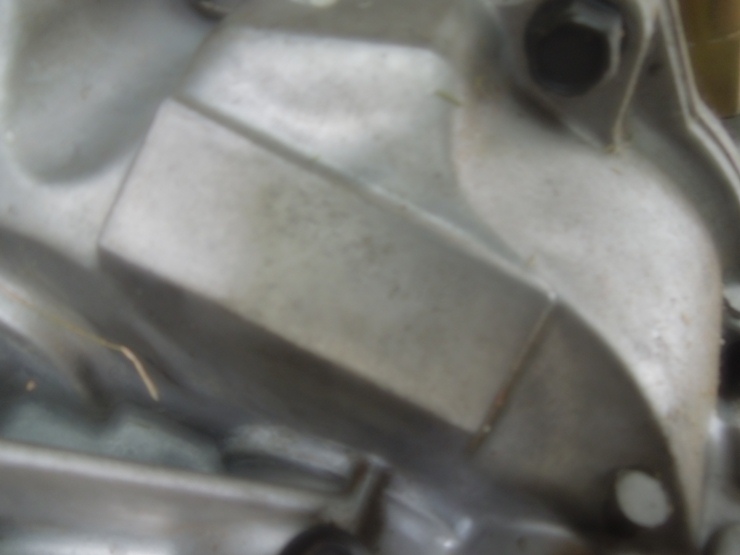

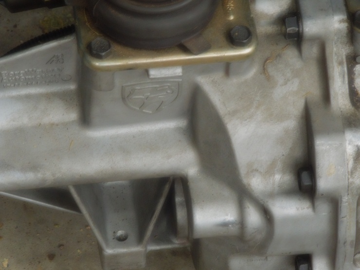

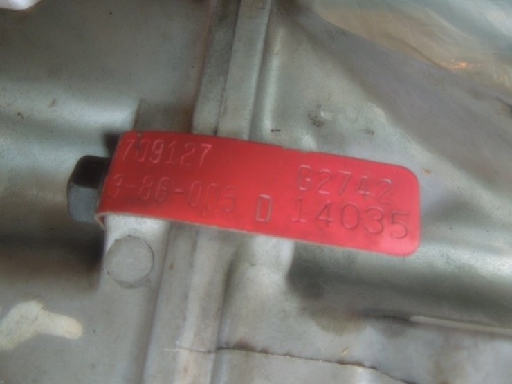

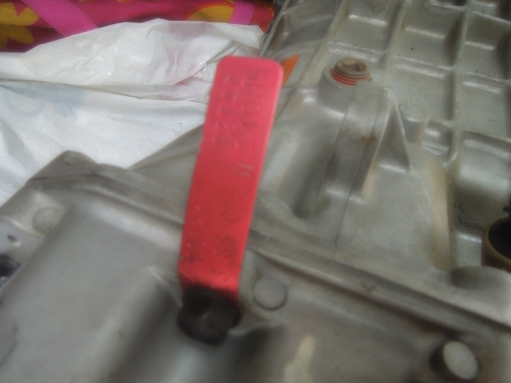

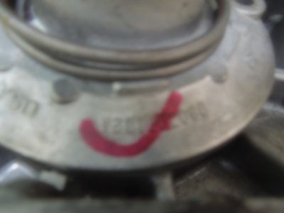

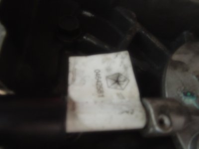

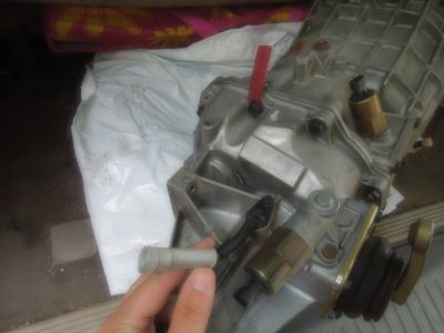

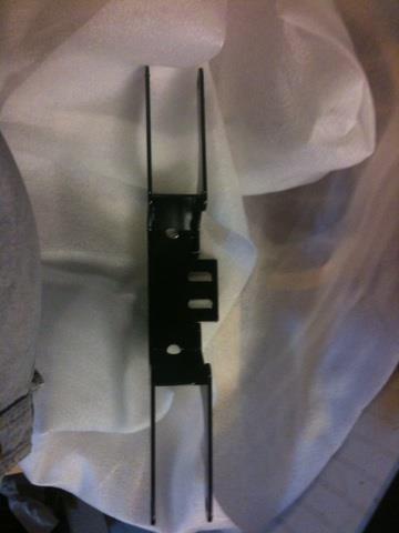

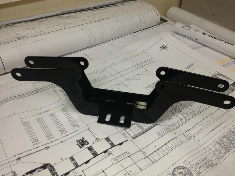

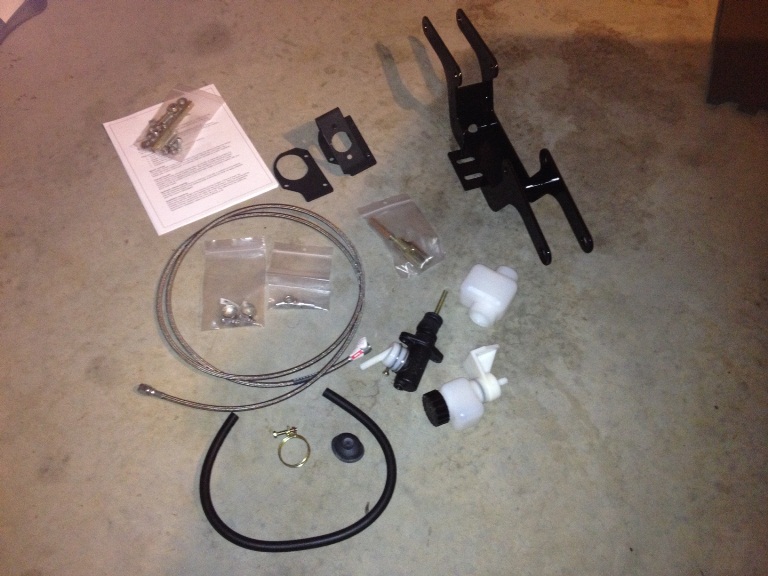

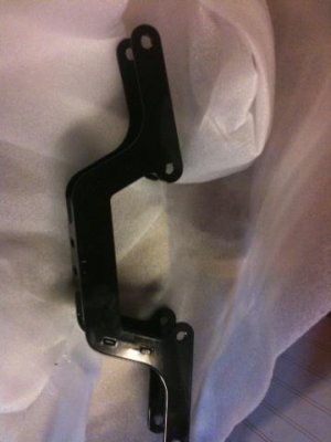

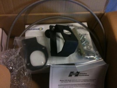

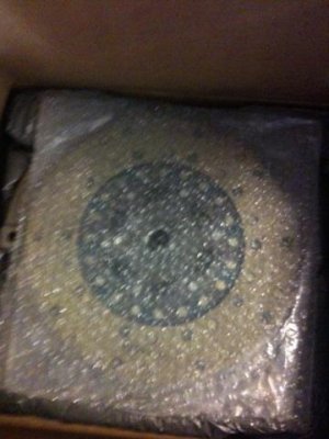

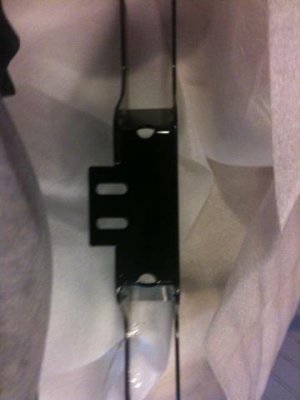

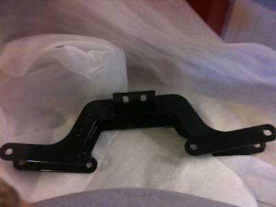

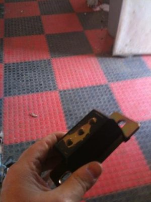

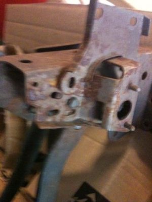

viper tranny crossmemberphoto(50).JPGone small step closer

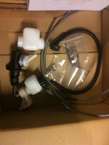

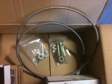

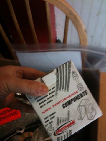

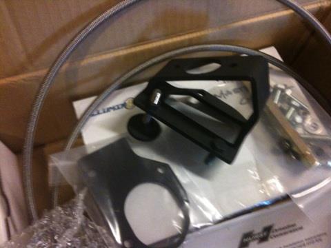

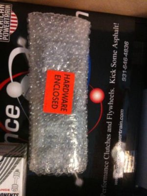

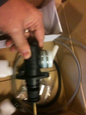

Good morning Stuart -
Here is a photo of the components that I can provide. I just noticed the the cross member hardware is not shown, which is included. Let me know on these.
Prices are
Cross member - $199.00
Hydraulic Master Cylinder Mount - $ 79.00
Line set and fitting - Earls - $29.00
Tilton Master Cylinder - $ 75.00
Includes all the reservoir options shown.
American Power train had 10% off today for cyber monday
so i called and ordered the rest of my stuff

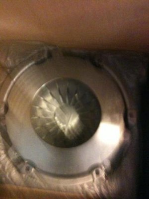

FWCH-10001 FWCH-10001, SCIENCE FRICTION Billet Steel Flywheel, SFI
Quality, 130t/10.5", Chrysler 6-bolt, Neutral Balance, Big Block,
318, 340 and CB 1972-73 6-Pack 440
229.00 229.00
BHCH-28073 BHCH-28073 - QT SFI Bell Housing, Chrysler Big Block/426
HEMI to Viper T-56, 130t fw only
539.00 539.00
CLCH-12203G SCIENCE FRICTION 107523C MEAN STREET STAGE 2
KEVLAR CLUTCH KIT, INCLUDES:
HIGH CLAMP LOAD LOW FLEX FORMED PRESSURE
PLATE,
23-SPLINE FULL FACE KEVLAR SPRUNG HUB DISC,
STAINLESS PILOT BEARING,
ALIGNMENT TOOL,
535 FT-LB RATED,
LIGHT
FSGM-10001 #910 GM/Mopar Pressure Plate Bolt, Set of 6, Race Grade 8 18.00 18.00
FSGM-10002 #912 CHEVY/MOPAR/FORD FLYWHEEL BOLT, SET OF 6,
Race Grade 8
15.00 15.00
Subtotal ------->> 1,699.00
