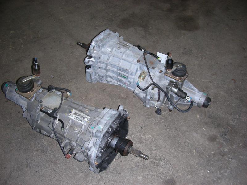

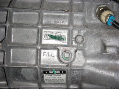

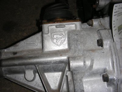

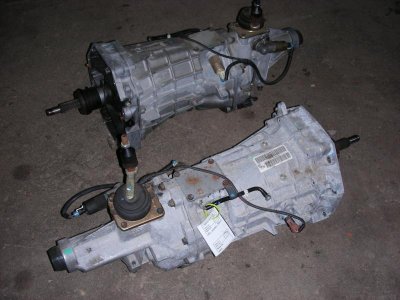

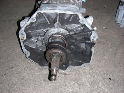

Right on time, I'm pretty impressed that even being shipped freight they showed up right on time.:headbang: Everything looks great and they are definitely smoother feeling on the shifter.

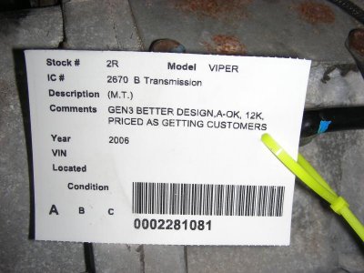

The tag on Goons tranny
I already like the internal hyd setup better on these compared to the TKO, there's an external bleeder right where it should be (on the high side). Should be easier to get a firm pedal!
No denying what they came out of haha

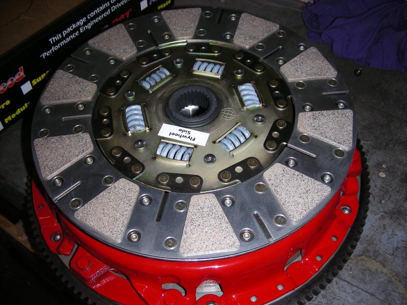

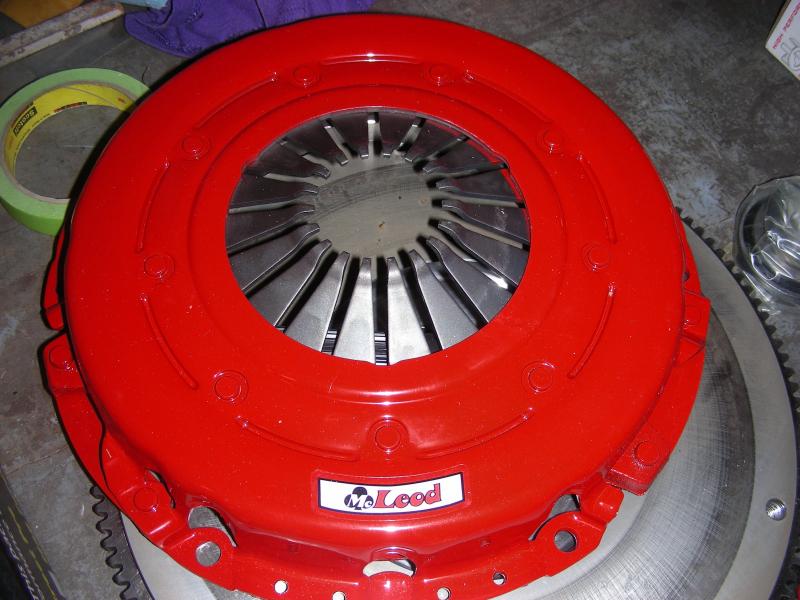

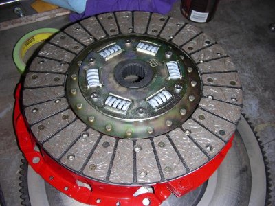

I've been buying parts ahead of time so here's what I've got so far. The clutch, rated for 500 HP which I think will be fine with my street tires and a motor that likely doesn't exceed that.

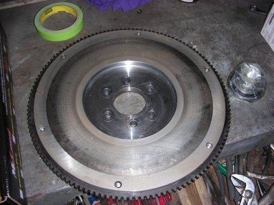

I had a brand new Ram flywheel but unfortanetly while removing the one from the TKO I failed to realize that my lead hammer had worn threw to the steel handle and I put a few dings in it:angryfire:. I sent the buyer the new one and will have to clean this one up now (it's new too, kinda).

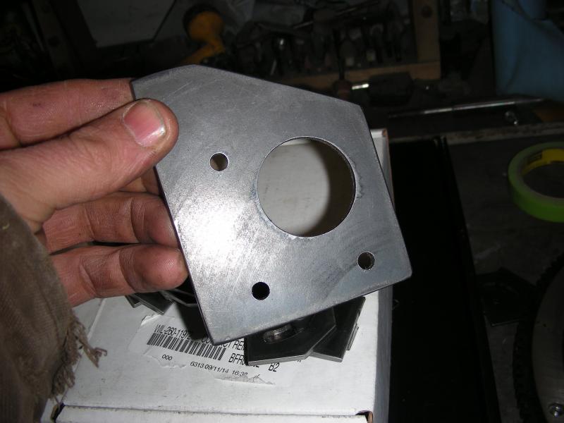

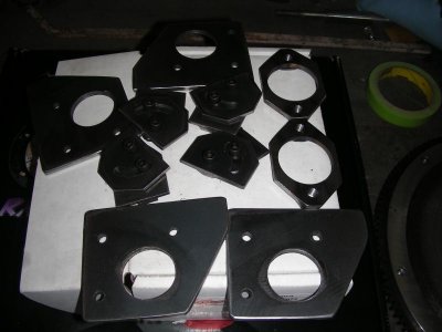

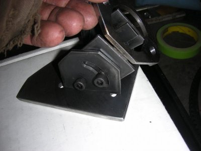

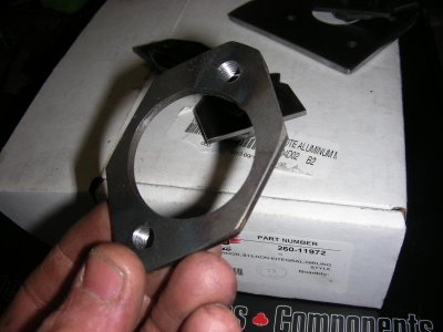

Here's the pieces I've been tinkering with to make the master cylinder mount. The goal is obviously make the angle adjustable so I can play with the fulcrum point increasing or decreasing pedal movement. The first pic is the master cylinder side.
Then the firewall plate (there's 2 to sandwich the wall), these bolt right over the existing clutch linkage hole like the Keisler adapter did.
I'm trying to hold them so you get the just of it, I'll get them welded up soon. I'm petty proud of my McGyver moment on the radiused slots. I don't have an indexing head for the mill so I just bolted it down snug on the pivot point, temporarily welded a long handle on them and proceeded to manually swing the pieces (all 4 stacked) on the mill making the needed slots. Who needs a stinking indexing head anyways haha........... Actually I'd love to have one!
And as you can see I accidently made twice as much as I needed...................... Guess Goon can use them.
The mount

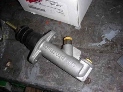

The master cylinder, I chose the 13/16 bore for the extra capacity hoping to reduce pedal movement (I hope I don't regret it).

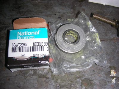

Pilot bearing, what's the odds that there's a pilot bearing that both fits the bigger converter hole in the crankshaft and a Viper input shaft? Can't believe it.

here it comes . . .
FER RACIN'
YEAH . . . no that's what I'm talking about ! ! !
Next to this one Tranny I met one night in Vegas THOSE are the prettiest trannies I ever did see!! lmao!
Seriously I can't believe how fast they arrived and how nice and clean they look. Beyond that the Fab work you're doing is amazing as usual (lucky me for 2 of everything:) And it's great to start getting an idea of what's involved. Have you received and shipment notification on your bell housing? Worst case if you're in a jam (and have room on a CC) you could always grab one at full pop from Summit then just return yours to summit when it arrives. (keeps you from waiting)

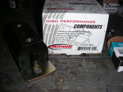

Parts list, source and prices. I'll keep updating this list as I go but I think I'll be in it for about $3,000 (I already had the flywheel and the driveshaft will be around $200.00).

Prothane mount PTP-6-1608-BL...............................Summit $45.57

Willwood 13/16" Bore master cyl WIL-260-11972.......Summit $64.76
