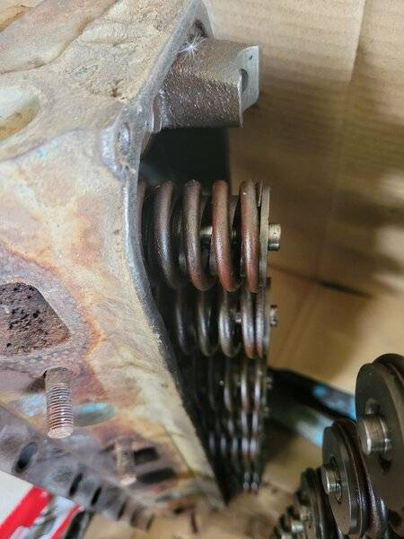

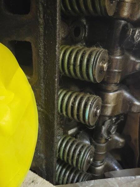

Yes, my numbers matching 440 always had single springs. Second owner from '70 confirmed that.
No, they had a single spring with a damper inside.
Yes, this is what I meant to ask... "dampner". It does not have those, which I am used to seeing on the HP 440. This is the earliest HP 440 I have ever torn down, hence the question. Thanks.
I see dampers in the pictures above.

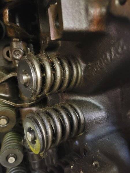

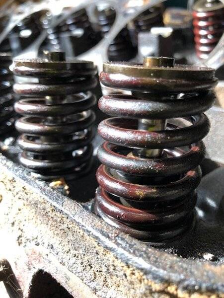

Here's a 68 383 2bbl 906 iirc and a hemi spring on a 915.
The lo perf springs stand out from the abundance of winds
