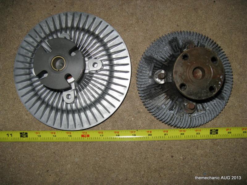

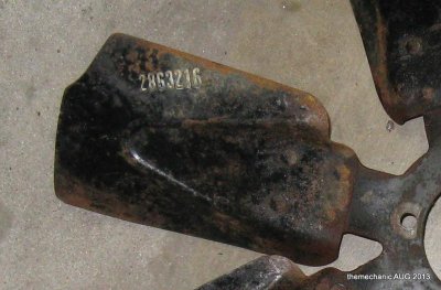

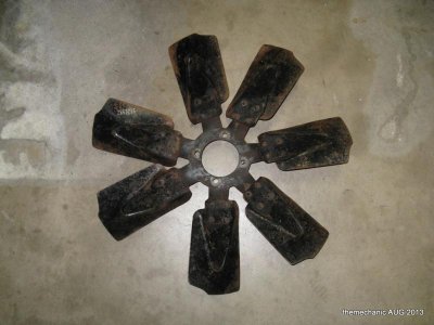

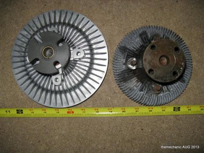

Here's a photo of the fan I bought with clutch from an Ebayer. It's the original 7-blade fan with part number painted on one blade and one of the old fan clutch beside the new Hayden.
