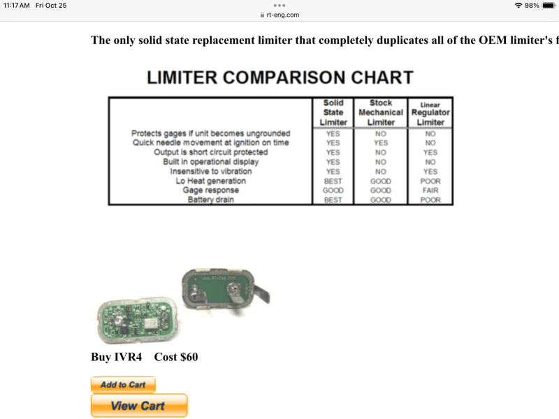

For the money, the RTE regulator is worth it. It has some additional protection features for controlling voltage spikes, grounding loss, etc. Easy reference comparison from their website.

Hi, did you use IVR4? Thanks
IVR4 Limiter List - rte

According to their website I believe yours would be an IVR3
IVR3 Limiter List - rte
