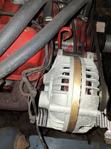

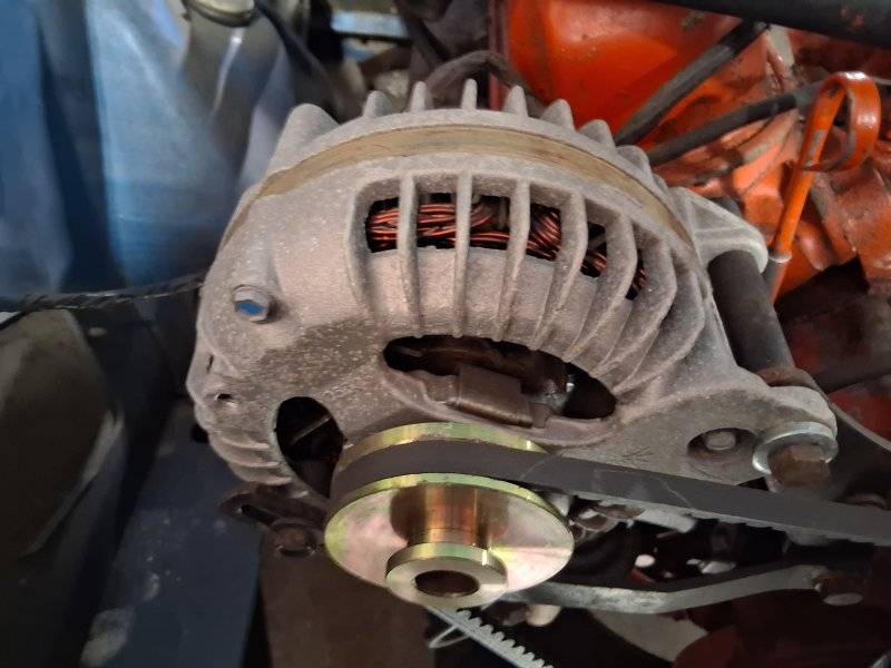

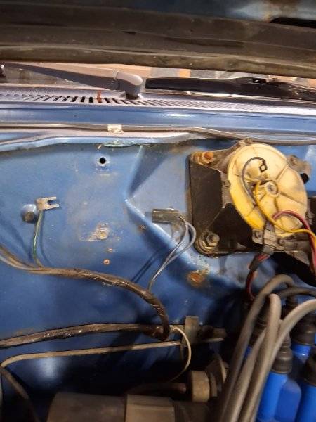

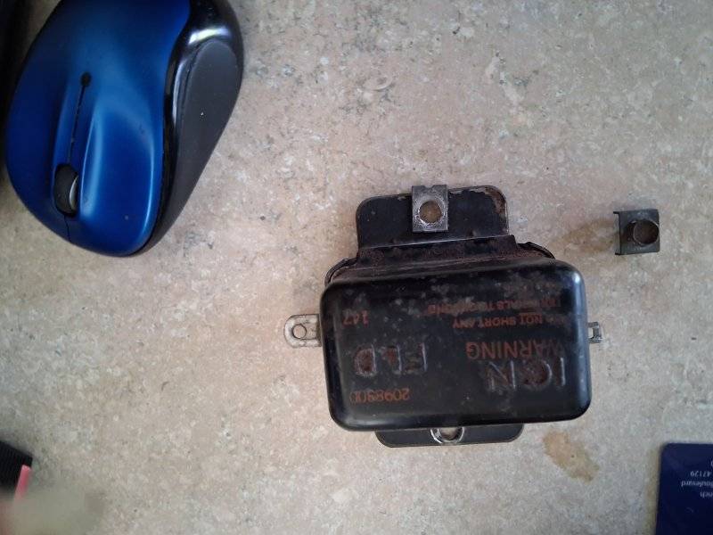

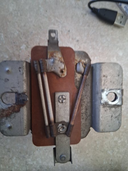

Hello Bob. Thank you for responding. My car is all origina as far as I know although I bought it used so if parts were replaced before i got it I don't know. The voltage regulator is rectanglar. The case has two connectors. One is marked FLD and the other is IGN. The FLD post has a small green wire and the IGN post has a slide on connector. Here are pictures of the voltage regulator and where it attaches to the firewall. Front and back of the alternator.

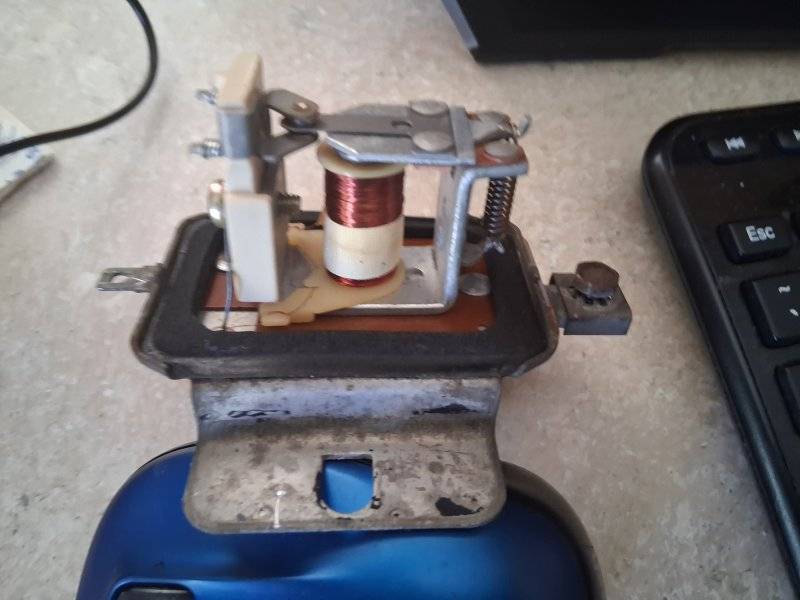

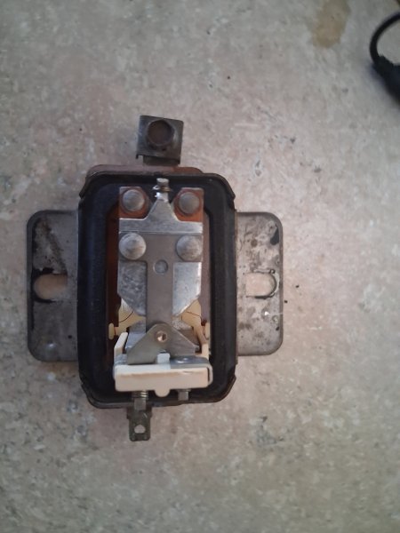

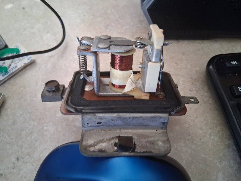

Pop the cover on your regulator and have a look. And or post pics
