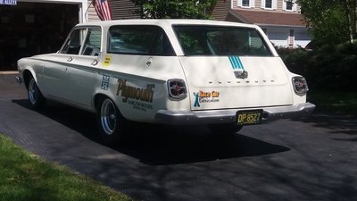

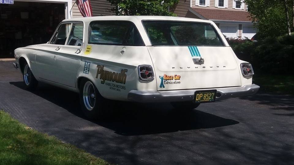

I have a 275x60x15 with a 15x8.5 with 3.75 BS
this has the stock 65 b body 8.75 diff and it is the crager ss 15x8 rear wheel with 28x10.5 M/T slick
