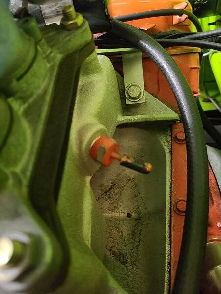

1mean66 I hope that tarantula looking vacuum fitting didn't sway you away from the intake as a source for vacuum advance. Those fittings come in many shapes. I attached a pic of the one on my 6 pack manifold. Most manifolds will have a 3/8 inch pipe thread port for vacuum to operate power brakes and other accessories.
No Not at all. Have all kinds of them at home in the shop. Have spun wrenches since 68. I am just trying to figure out where to put it. If a take my time (usually don't) I can just cap anything that does not do what I think I want it to do. As stated else where if I got a sniper injection it solves everything except cost. Car is becoming a driver, and it is definitely not a show car. It goes to shows, but we invite all the little ones to climb in it and have fun, they love the "monkey bars". What I think I want is the vac. to start tipping in at about 2K. And I do realize that any time the throttle moves that advance "goes away". If I tap the manifold I will have it lower than that. Thought tapping carb. spacer would work , but may be to high in intake passage. But I'm thinking I will try it there first ( have an extra 1" spacer) cheap ( inexpensive part) to screw up. I actually but a vacuum port in my valve cover. Sure now your thinking What is wrong with this _ucking idiot?
