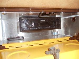

I had the local restaurant fixture fabricator (sinks, etc.) make me an exact copy of the glove box insert in food grade stainless steel. Access hole in the rear for radio antenna and wiring. Glove box light hole in the side. I guess to work the remote, the glove box door must be open. The radio is a tight fit, I can just barely close the door.
Some day I will find a way to install the Mopar NOS power antenna I purchased that was used on the C Body. So far, the curvy front fender on this '71 Satellite is not cooperating.

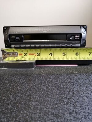

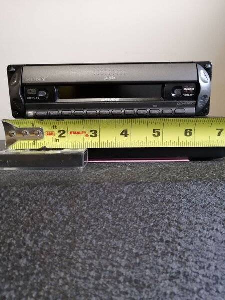

I have this. On sale at A for $30

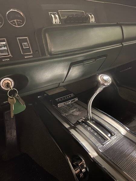

Not sure if you can see the Realistic FM convertor to the right of the shifter in this pic. It actually works, but the dash speaker is blown. I have another radio/cd player that I may replace it with, along with a set of new speakers.

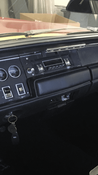

I have a retro-sound head unit in my car. Looks stock and has great sound. Have the matching speakers front and rear from retro sound. My original am radio didn’t work so I bought this. I really like it. Has Bluetooth so I can sync my iPhone to it. Anyone else have this?
