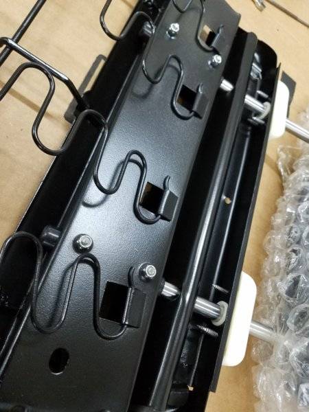

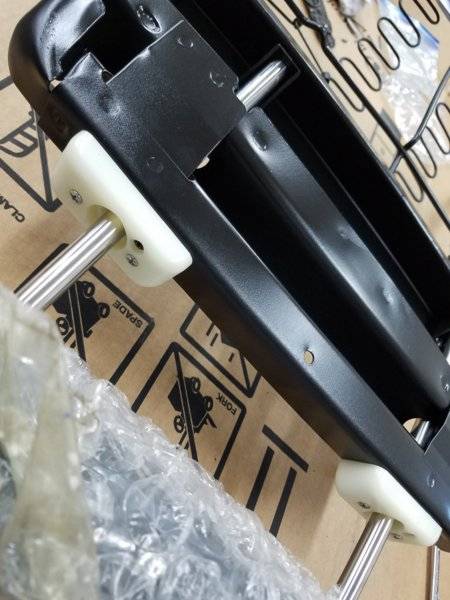

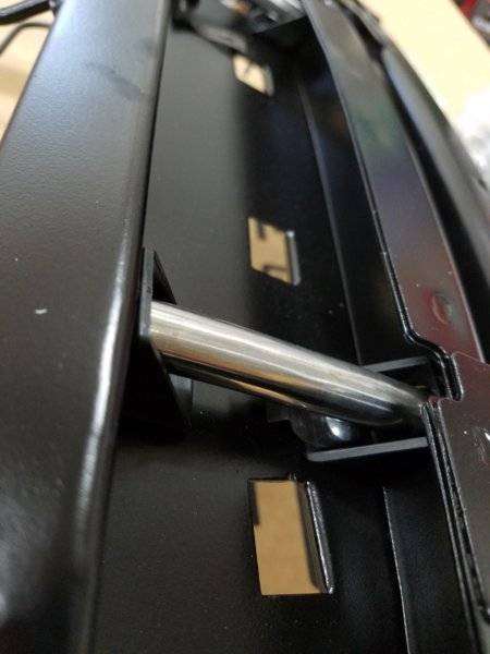

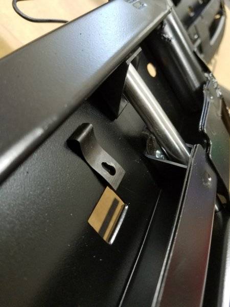

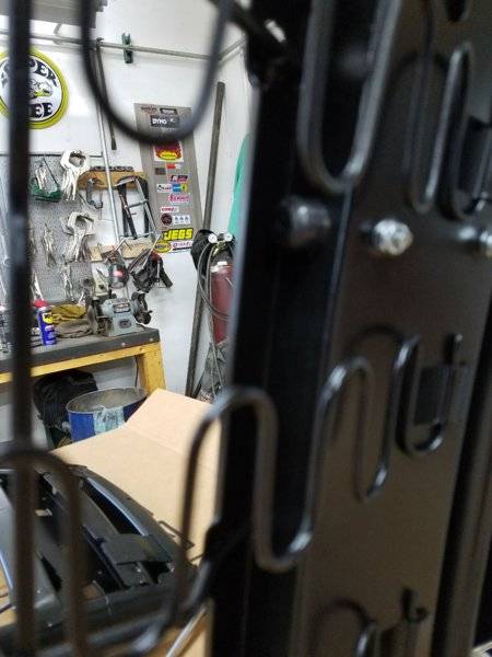

Just going through this on my Bee. Converted from bench. Found some seats from a 68 Coronet that didn't come with the headrests. The kits for some reason don't come with the mounting hardware. I ended up making the holes in the seat backs a bit bigger and using 8-32 screws and nylock nuts. The metal spring clips all needed their holes elongated to allow them to move up so they would lock into the poles. I also had to do some filing on the big holes on one of the backs to get everything to fit nice.
View attachment 809203 View attachment 809204 View attachment 809205 View attachment 809206 View attachment 809207

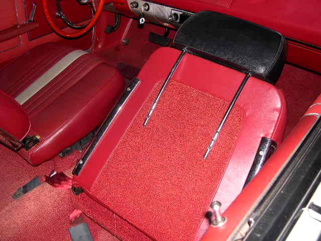

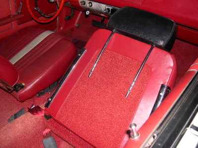

I installed rests on my '63 buckets finding most of what I needed on ebay for pretty cheap; I might have been lucky on the late 60's headrests I found for under a 100 bucks shipped. Added a bracket inside the seat back to hold the posts in place similar to what is photo'd above. The hardware set for the posts I got for around $25 on ebay.

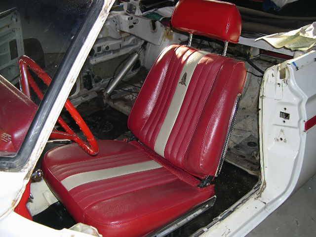

I needed headrests at the advice of my surgeon as I had a partial neck fusion. He said a whiplash injury could be very bad for me. I started hunting for later buckets as my era buckets of course never had them. After finding a lot of pros and cons, size, costs, etc. got the brainstorm of adding them to my seats finding headrests and hardware on ebay as I posted earlier. While I had concerns about the seat back height being a smiggin lower than later 60's this ended up not being a game breaker for me and all done for under 200 bucks. Posted couple pics of my seats before (starting to size up the rests I bought) and after while I was still restoing my car.
View attachment 809797 View attachment 809799
Seems like you did very well. Just a single headrest is going for 200 on Ebay. YearOne hardware kit is 150. Appreciate the info. I gotta start digging, lol
One of those rare occasions when ya get lucky...right time right place! They were like brand new and a shame color didn't match. While I thought the rests were a nice price didn't realize just how nice until doing more checking.

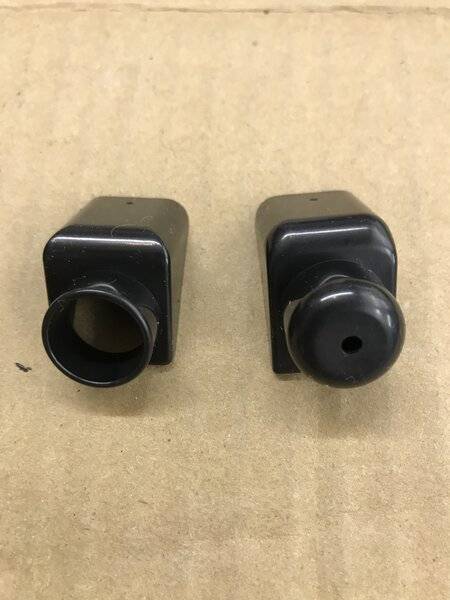

Are these pieces for the headrest installation correct? I assume the one on the right goes on the bottom and is the lower stop for the headrest. I don’t have my headrests yet to check. Once installed do the headrest go all the way down to the top of the seats?
I am asking because I was surprised when I opened the package and all of them didn’t have the large hole.
