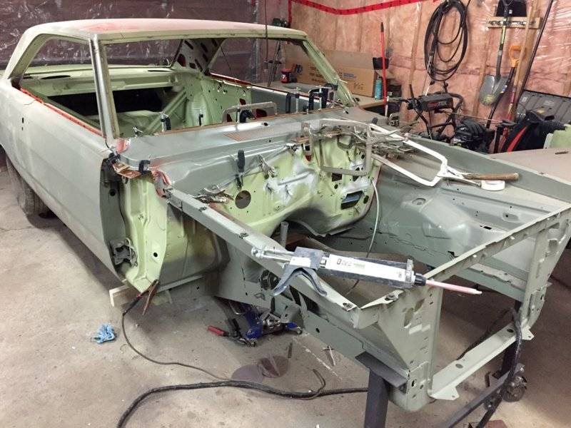

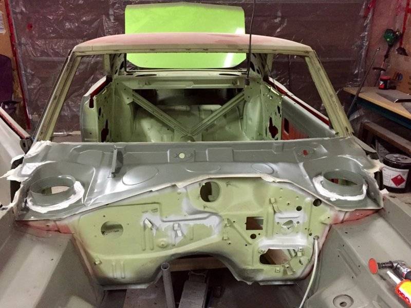

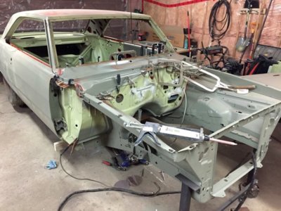

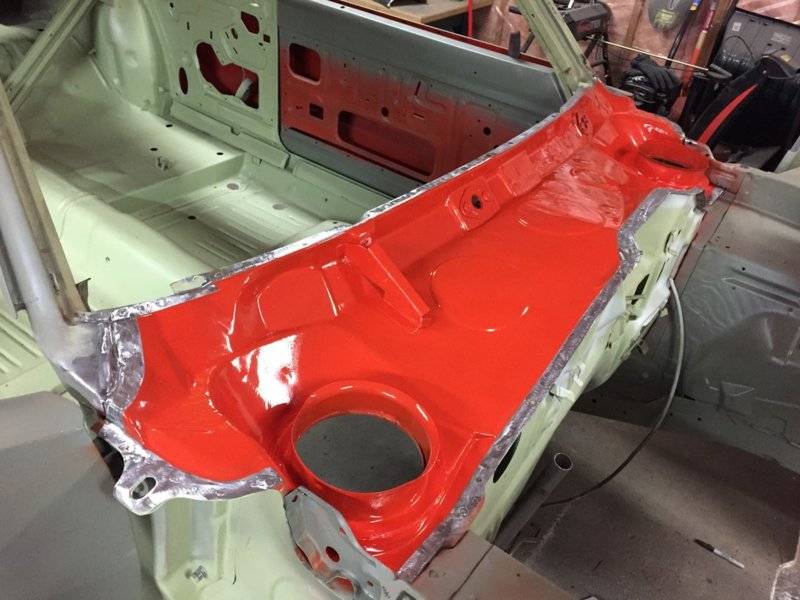

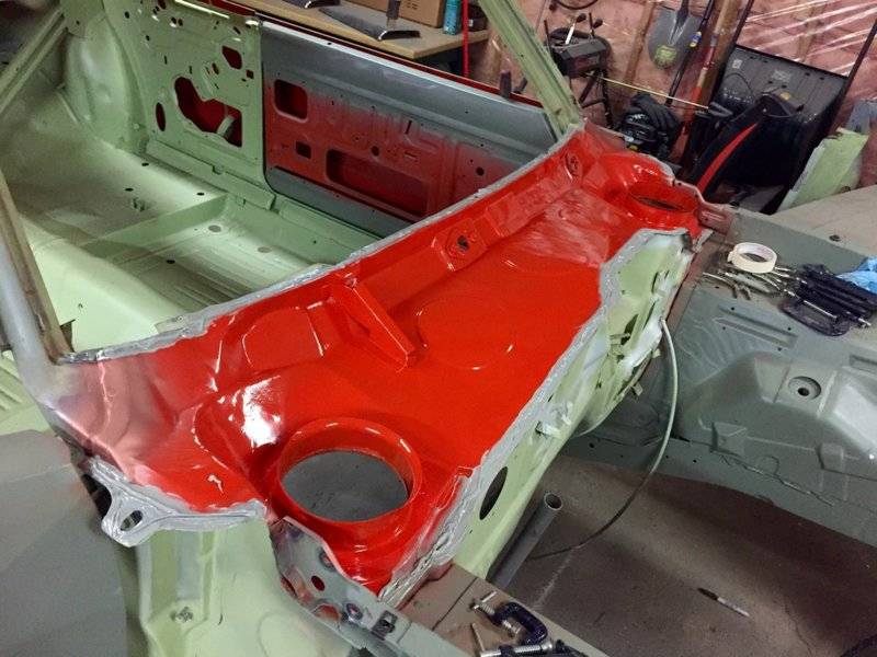

Cowl clogged up? Cowl to heater box gasket worn out. Seam seal around the cowl hole into the box. Just wondering if there is a way to seam seal the cowl area without taking the upper cowl apart. I found some pictures of an A body in this process. If you look on the left cowl hole you can see the seam sealer around the base of the "stack".
I have just rebuilt the heater box and will be putting it back in the car. But wanted to see if there was a simple way to clean out the cowl area.

This is where the Dodge trucks were cool. You can remove the cowl with screws and clean inside it. Once the car is welded together, no way to really get inside there from the outside.
You show this car as an example. I take it the car you are working on is not apart more than the heater box removed.
