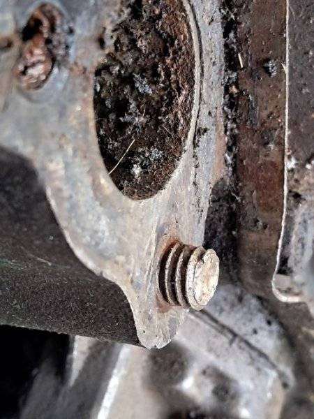

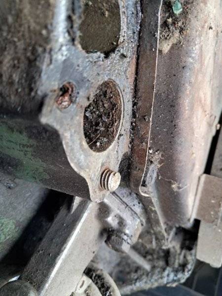

Water pump bolt broke/stuck into the block. Any ideas how to extract it?

Any and all ideas are welcome!

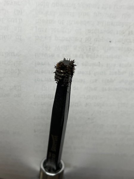

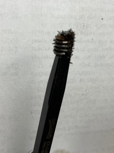

That happened to me and I don't have a welder, so I boiught an extractor drill bit set. You drill a hole into the broken bolt and insert the correct size bolt extractor and turn it counter-clockwise to extract. Just make sure you use a punch to get the drill centered, drill into the broken bolt and select the correct size extractor bit. You insert the bit using either a socket wrench with an extender for torque or a t-handle tool, which should be avaialble wherever you buy the extraction kit. It worked for me. Good luck.

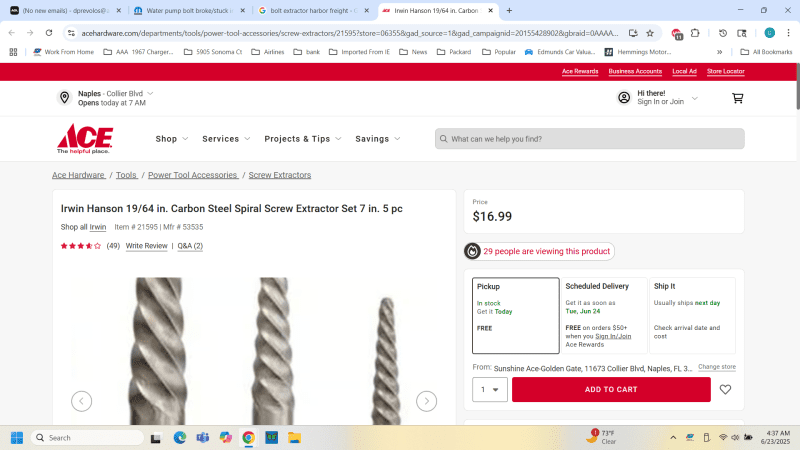

I have a Irwin/Hanson set of left-hand drill bits and easy-outs. 10 piece Extractor and drill set with left hand cobalt drills.
11119. The kit costs about $40.00 and is well worth it. It really works well on just broken bolts, but not rusty heated bolts.
The left-hand drill itself will sometimes remove a broken bolt, but if it's stuck a little more, the easy-outs will do the job.
