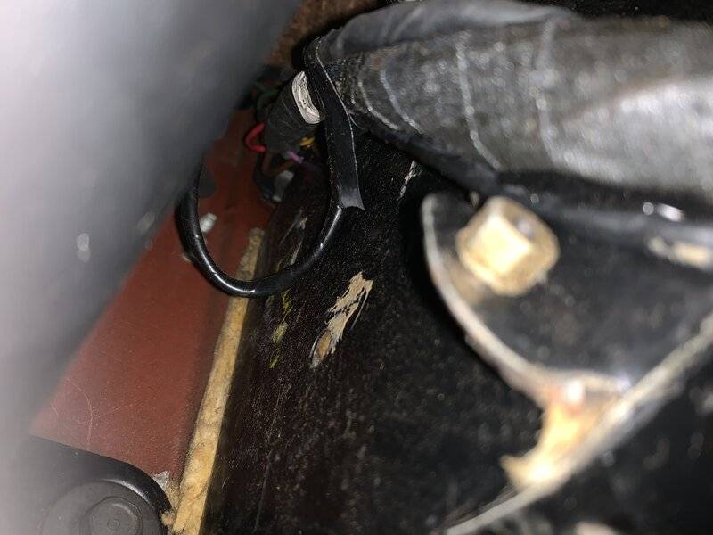

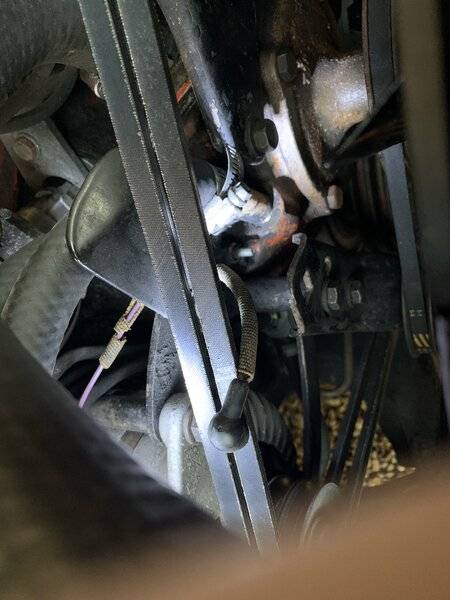

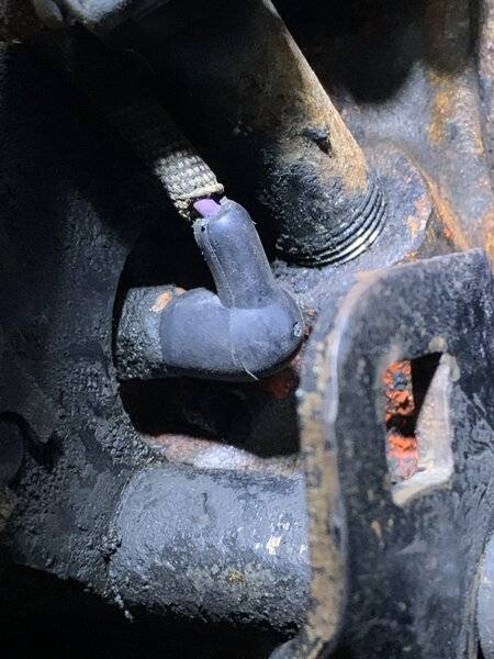

We removed this plug (which i think connects to the sending unit?) and reconnected it, also wiggled on it. Made no difference.
We also wiggled on all these cables, made no difference either.

I think this is the oil pressure sending unit?

Pull and check the instrument fuse, along with it's clips for rust or corrosion. Also at the bulkhead connector, clean all terminals on the engine harness and also in the bulkhead. Intermittent problems like that are sometimes tuff, but seem so simple when found. Have you ever seen a glass fuse that looked good, tested good, but came apart when removed?
first I would test the gauge itself by grounding the wire to the block to see if the gauge moves (get some one to help you and don't let the wire ground to long of a time), if the gauge doesn't work you have a wiring problem. Next clean the sender and wire connector with sand paper to clean them, then with the wire connected start the car and see if it is working, if not the sender is bad .
Good advice above. If you check the sender wire with a dc voltmeter, you should see a 12v pulse. And the key has to be on for the grounded wire test. As moes said, only briefly.

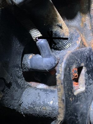

Do like Moe's said. And yes you ground the wire in your last pic, momentarily! Have someone watch the guage for movement. Then report back.
Did that (also cleaned the plug/wire) but gauge does not move.
Tried with ignition on and even the engine running.

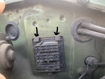

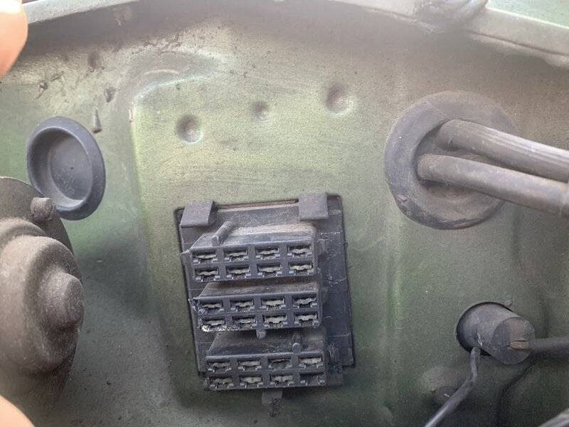

We removed all three plugs and cleaned them such as the bulkhead itself. (Picture before cleaning)
We did NOT remove every single wire from the three plugs that connect to the bulkhead.
I hope we dont have to but probably will if nothing else works...

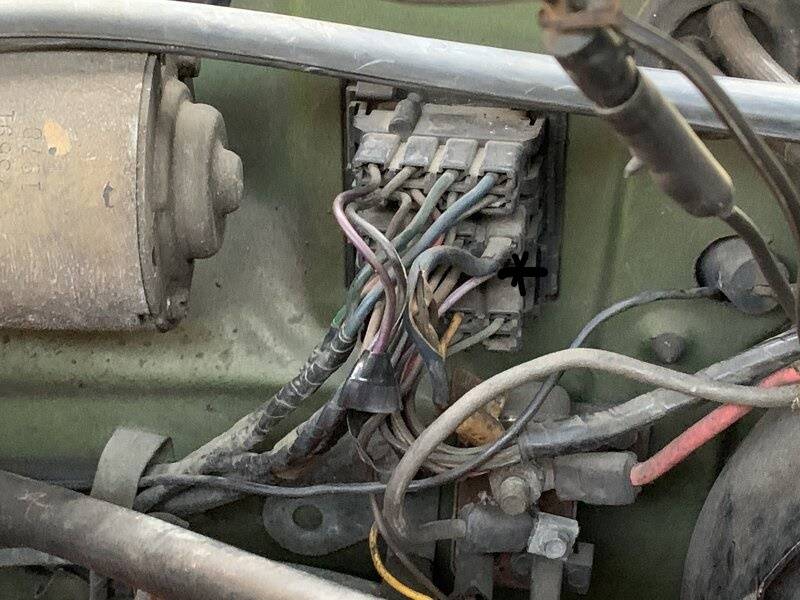

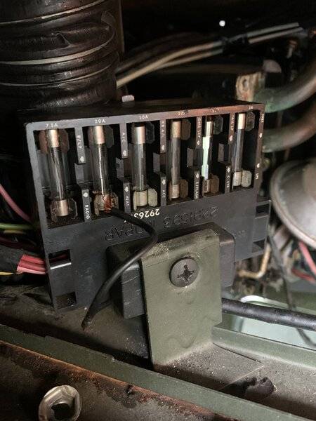

Is this black wire at the front of the fuse(box) stock?
I would suspect no? What could this probably do?
right side, 4 down. Underneath that nasty inline fuse coming from the relay

Today we connected this end of the wire directly to the battery plus
https://www.forbbodiesonly.com/moparforum/attachments/tttt_li-2-jpg.1144657/
and checked with the multimeter on this end
https://www.forbbodiesonly.com/moparforum/attachments/temp-2_li-jpg.1144659/
Result: Perfect constant voltage (same as directly on battery) even when wiggling the wire at different places.
We also checked the fuse box with a multimeter and every fuse has 14V except the instrument fuse (the one all the way to the right) which only
has 8-9V. It also only has voltage when the lights are on but this is normal as far as i know?
But is it normal that this fuse only reads 8-9V while all the others read 14V? If not what could be wrong?
We had the fuse out and also checked the fuse and & fuse box for rust and corrosion but it does look pretty good. Fuse is not falling apart...

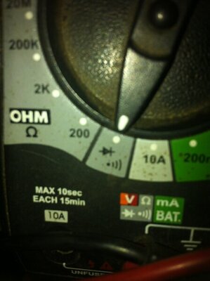

To eliminate that wire under the hood so is not the problem, I would check the continuity of it with multimeter first.
Place one lead on the bulkhead wire I showed you and the other on the the end of the wire connected to the sender, the multimeter should beep meaning
the wire is ok, no beep wire is no good. If the wire is ok you know that the problem is between the bulkhead wire and the gauge or the gauge itself.

How good did you clean the connection in the bulkhead and the wire to the sender unit, you want them shiny looking?
We used contact spray and compressed air.
I personally wasn't shure about using contact spray but my dad said it won't hurt anything...
The contacts on the plugs that connect to the bulkhead look pretty good, we did nothing to them.
Maybe we didn't clean the connections good enough but how to clean the bulkhead otherwise since you cant really fit sand paper in the connectors?
I got a feeling your problem is in the bulkhead connection and the wire.
I've seen the connectors in the bulkhead spread apart some so the connection is a loose fit causing the problem to.
So I would crimp the connector down a little so you get a good connection between it and the wire from the sender
I will check this and everything else over again.
Maybe it's really just that we did not clean the connections good enough.

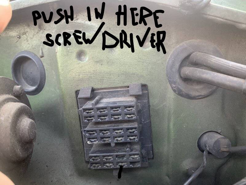

that will not work, you need to use sand paper or a small file to clean both connectors. (Male and female)
to clean the bulkhead female connections disconnect the three plugs. Then push on the two tabs at the top of the bulkhead to release it. Then push the bulkhead in towards the inside of the car. Then go inside and pull it down so you can clean the connectors. Done it many times on different cars. Next get a small screwdriver and press it into the little slot to release the connector from the plastic bulkhead. Do one at a time so you will not mix up the location of the plug. Clean it and then take small pliers to close up the gap a little so it will make good contact with the male plug when you connect it. Make sure you bend the tab up before putting the connector back in to the plastic bulkhead so it will stay in place. When done just push plastic bulkhead into the firewall hole till it clicks in place, there is only one way it fits. You can use the screwdriver to release the male plug connectors to, so you can clean them. Before connecting them put some dielectric grease in the bulkhead connectors so they will not corrode again. Do all the connectors once and you will not have to do it again in the future.

To eliminate that wire under the hood so is not the problem, I would check the continuity of it with multimeter first. Place one lead on the bulkhead wire I showed you and the other on the the end of the wire connected to the sender, the multimeter should beep meaning the wire is ok, no beep wire is no good. If the wire is ok you know that the problem is between the bulkhead wire and the gauge or the gauge itself.
Did this and it beeps, so the wire is good.
What we also did was (with the plugs from the bulkhead removed) placed on lead from the multimeter on the female bulkhead connector and the other lead
to the male connector/pin on the plug that connects to the bulkhead.
Tried that with ignition on and off. It did NOT beep.
But i think this is probably normal? I just tried it since we already had it apart...
I suspect you did it on non A/C cars? Because the heater/ac core (box) is in the way. I can't pull it out.
I can barely see it and can't even reach it with my fingers.
We also tried to pull the bulkhead out in the engine bay direction but this seems to be impossible as well.
Anyway we still cleaned both the male and female pins/plugs with a small file without removing the bulkhead as good as possible.

is tape on it and i'm questioning if all wires and locations are stock.
Oh man i was hoping i would NOT have to deal with shaddy work from previous owners/restorers since this is a survivor car...
I never had another mopar so i dont know if its stock or not, tough. :)
Sure looks like there is a non stock blue connector peeking out from under that black electrical tape. I would open that up to see what is going on there.
Can you mark it in the image?
I posted 3 different pictures and i'm not really seeing what you mean?
Not sure how to mark pics? It is in the interior shot by the steering column. To the right of the white connector.
