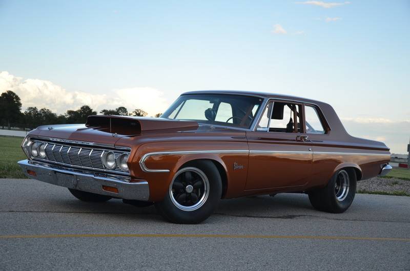

Thanks. Lots of nice stuff here. This picture wasn't to show case the car. Rather to show that you can get them light and still look pretty stock.

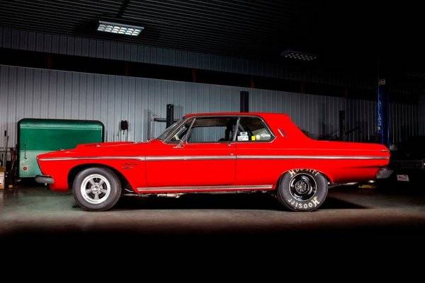

That's not to bad. My 63 is all steel with all factory glass. It does have a glass hood but I added a 6 point rollbar and frame connectors and it has power drum brakes with a full exh system as its a street car. Standard radial street tires up front and radial Hoosier slicks in the rear. It goes 3725 with my 180 in the car. Ron
