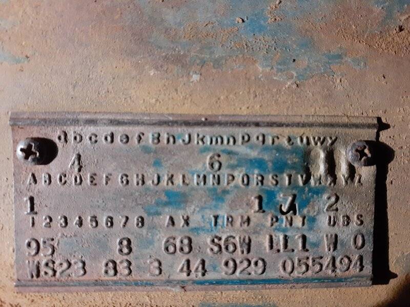

I assumed that it was a factory vinyl top, until I learned how to read the fender tag. I even had to unscrew the tag and clean it up real good to be sure, but it does not show there to be a vinyl top on this car from the factory.
I wonder if that was a mistake and they didn't mark it on the fender tag, or if somebody just added it later.

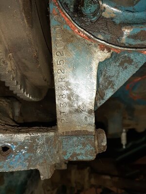

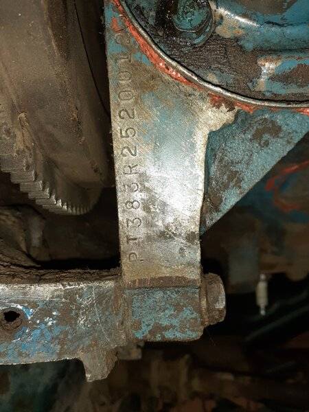

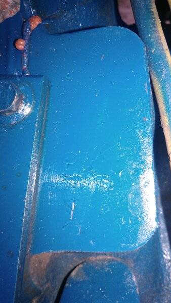

The second thing is the engine stamp on the bottom near the oil pan is wrong.
It is a D 440 HP2, stamped on the top of the motor, but on the bottom it is stamped as a 383.

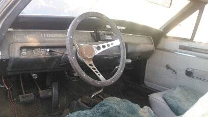

The third thing is the Tachometer. On the fender tag it says its supposed to be a clock with tach, but its just a tach. This is not a ralleye dash.

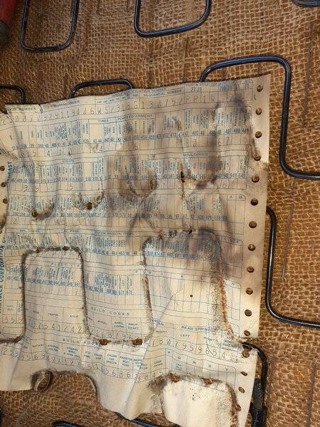

I found a build sheet under the back seat, and left it alone all those years, until recently and I carefully got it out and it is for a different car. Still a 68 RT, but a red car with an automatic.
I wonder if it was mistakenly put in wrong car or somebody changed the seats before I got the car.

Too much is made of those build sheets. Many original cars never got them, and some like yours got one from a different car. On the standard dash for an R/T you got a 150 MPH speedo, and optionally a clock, tachometer, or oil pressure gauge. You could only get one of those three.
The oil pressure gauge was probably more of a dealer installed thing, as it was more apt to be in a police package “K” car.
I guess mine got the tachometer. Thanks for the feedback, I have never heard that about the standard dash.
On the vinyl, time to be Columbo. If there was no factory paint, and the chrome holes have paint, I'd call it original.

I see no vinyl top code on the fender tag. Odd that the roof is not all painted body color under the top. The workers were to build the car to what the tag said, no guessing or changes.
You have the tach code without the rally dash code so you got tach only. the optional rally dash would have come with all gauges. Plus the clock and tach combo. Your decoder is wrong.
the seats went into cars randomly. So there were at least two sets of white seats there and they went into the wrong car. When the seats were assembled the broadcast tweet was placed in the seat. So they new what to build for the day. The seat installers new what seats to install by color and style, but never checked the sheets to go in the correct car. Happened every day.
the car scheduled production date is 9-29-968 so it came with an inland shifter. They switches 1968’s to Hurst later in the year. And the hurst shifter cars would have a reverse lamp on the dash. You car shouldn’t have that lamp either.

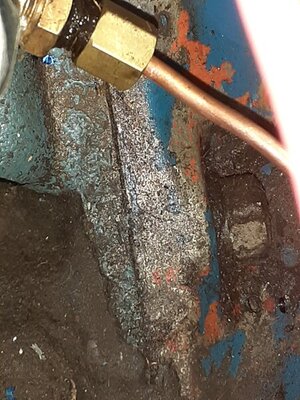

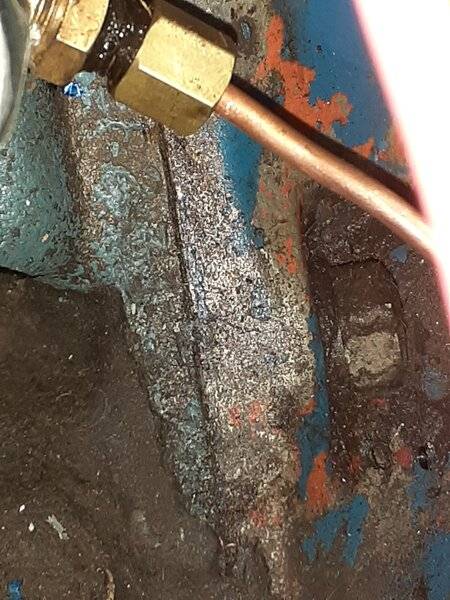

the engine numbers are a mistake. Look on top of the engine block behind oil sender, next to the bellhousing, does it have the last 8 of the VIN stamped there? It should.

There is a number stamped by the oil sender, but I haven't been able to read it clearly. There is not a reverse light on this car.

Back of the block by the bellhousing an oil sender.
should be on all 68’s with a performance engine.
I got you, I was just showing the front pad so you know it is a 440. Its kind of hard to read with the glare. I am looking for the picture I took of the numbers by the oil sender...
The date on the bottom is june 21, which fits with the June 26 date on the top. The person stamping the bottom thought it was a 383 two barrel engine.

Yeah, I guess they all look the same from the bottom!! Here is a pic of the oil sender area... There is a number there, but I cant read it...
