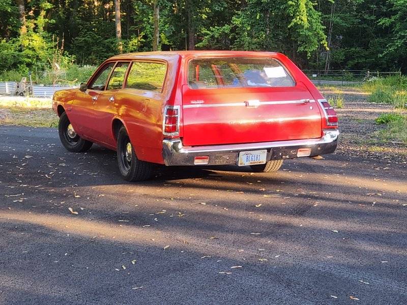

I was originally looking for a 69-to-73ish Town and Country. Had a couple of beauties slip through my fingers locally due to dithering on my part :BangHead:. I started looking for any kind of wagon on CL locally and when nothing popped up I started looking further out. I found this one on CL in Spokane, WA but the car was in Kalispell, MT. A ton of phone calls and emails later I drove up there with my trailer, inspected it, and brought it back. It's not perfect as very little was done to fix long-term stuff like cat whiskers and leaks, but otherwise it's in very good shape. I believe the clock is correct at 58K. There's no way this car has 158K on it. It's all original everything - engine, trans, interior, paint, etc. The last two PO's drove it a few times a year to get an ice cream so that was 15 years of sitting, luckily inside heated shops. It was originally sold in Butte, MT so it's entirely possible it was a MT car its whole life. Here are some more photos.
I've been doing shake-down trips around town to find gremlins (like the driveshaft falling out on the freeway) :eek:. This winter it's getting a new top end with a 4-barrel intake, Thermoquad, and HP exhaust manifolds from a 72 340. It will get dual exhaust, Speedmaster heads, a new 22" radiator, trap door air cleaner, and a slightly improved cam. All of that will be done up so it still looks as it does now - a plain-jane 318. It's a cruiser so I'm not going to scare anyone off the line. But I do intend to drive the wheels off of it.

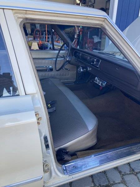

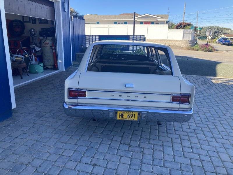

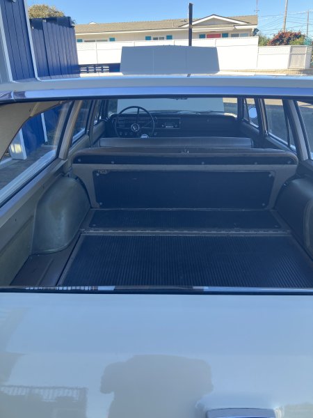

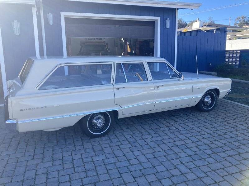

My wagon hunt is over. Picked up this 67 yesterday from a nice gent in Agoura Hills[ west of LA] that was advertised on FB marketplace. It's a deluxe wagon, wind up windows x5. Had a 318 originally, one of the previous owners put the 440 in. The gent I got it from freshened that up, went through the trans with good stuff, has a Hughes 2k stall converter, freshened up rear diff w 3.23's and a SG from the Doc. He also did the front disc conversion, 10.75", from the Doc plus a booster. Body and paint was done in the early 2000's, shows some issues but no big deal. Interior looks original, will get seats redone down the road[ a little mushy on the foam]. Has 14's on it with OE center caps, 225/70-14's. Front suspension has been done in the past. Included a set of 15x7 Cop wheels plus some matching center caps. Once my truck sells, as long as I have money left over from paying back the short term loan, I'll get some tires to put on the 15's and fill up the openings better plus try to get a fairly tall one in the back to help out the overall gear ratio[ cut the rpm some]. After that I'll rustle up a pair of caliper brackets for the 11.75" rotors, get a pair of rotors, get some better pads and latch onto some 11x2.5 rear drum parts. I want as much brake ability as possible using OE stuff. In the future I'm going to get the car scaled so I can choose t-bars, springs, sway bars etc to take the mush ride away. I have an extra 70 k-frame that will get swapped in as I like that sway bar setup better. It will get some SFC's, will use some 2x2x.120 wall square tube. This way I get the units plus don't cut the floor like I did on my 65 with the 2x4 ones[ intentionally]. There will be other upgrades later on but I'll keep it simple for now so the majority of my time and dough go to the 65.

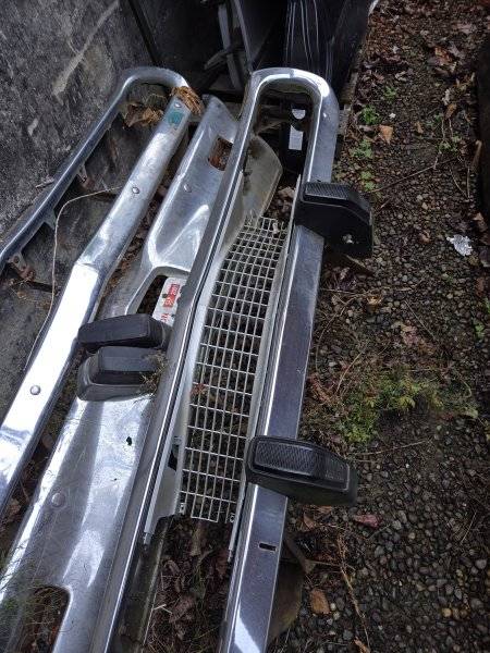

Hello , may a older thread but anywhere I love wagons , and long time I have my 73 Dodge Coronet Station Wagon, was a 318 car and actually runs with a 440-512 Stroker from my 68 Charger R/T .
I also specially looking for some peoples with 71-73 Dodge wagons , also because I want change the grill to a 71 grill and think the brackets are not the same , maybe more must be changed.
