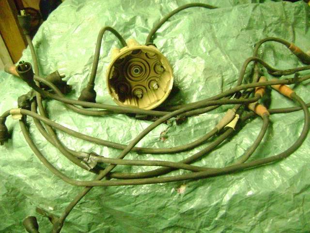

It was a rolling museum--literally the other day.
The original 2 - 73 date coded wires and cap took a dump.
The wires were shorting out and misfiring in the wet and the cap had a chunk missing and carbon tracks inside between terminals..
It is cool to know how original this car is but some things had to be replaced.

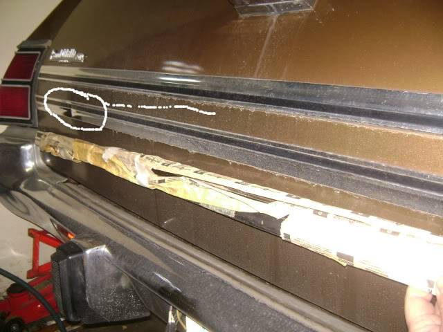

Did some digging and found that the M26 code is for the tailgate moldings.
They are unique to this car and are 1973 model only moldings.
Speaking of which.... I found a NOS molding to replace the dented lower one.

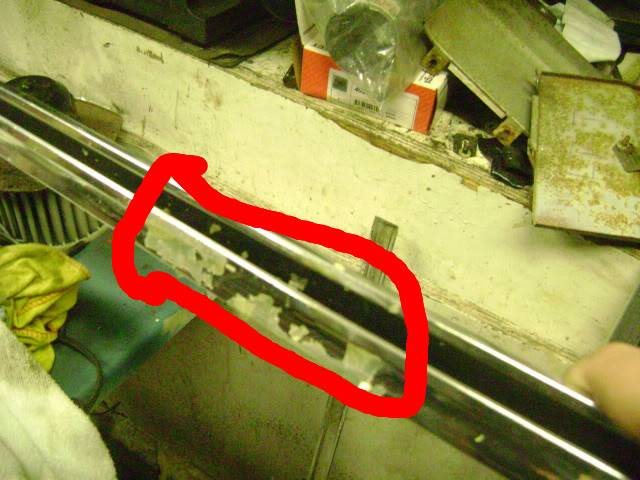

Be carefull buying NOS trim pieces.
Not all is perfect.
My molding had packing tape wrapped around it and the years of sitting and shuffling around the tape turned yellow and was stuck hard onto the surface.
What to do?

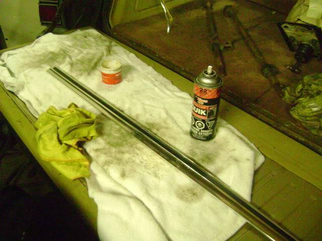

Using the tailgate as a bench (I love it!)
I sprayed the molding with a penetrating lube and let it sit.
it loosened up the tape and dried glue so I did not have to use a sharp edge in fear if scratching the surface.
After a good polish and buff with a soft cloth,it came up like new...or should I say NOS,LOL!!

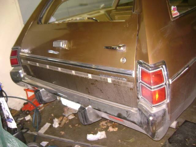

Off with the old...

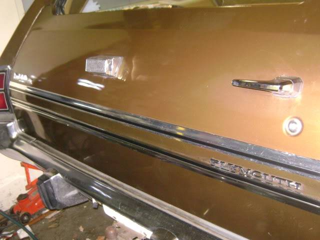

And on with the new.....old stock,LOL!!
