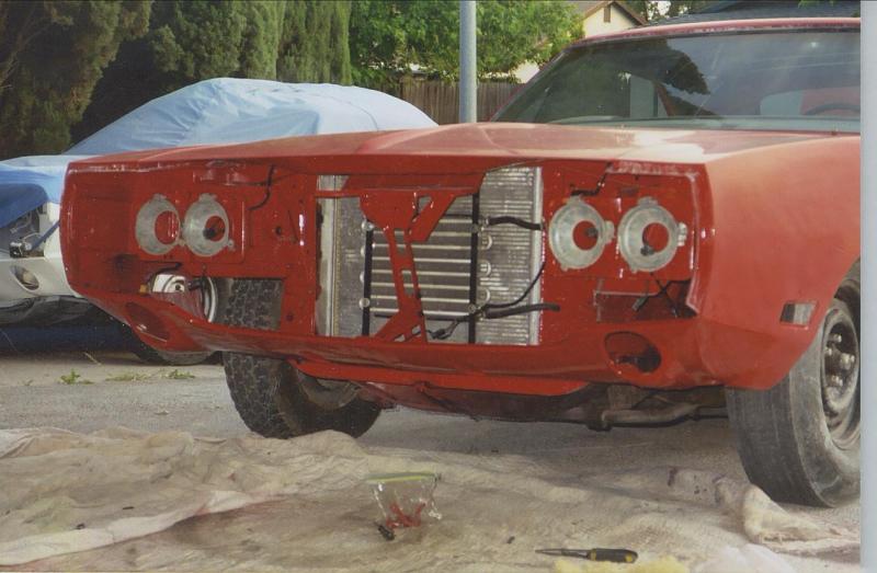

In 2003 when I was restoring my 70 Charger, I took the headlight mounting buckets to the table and ran them over the wire wheel to clean them up. About a half hour later I had some dizziness and a headache that lasted for hours. Someone told me later that the galvanizing compound is hazardous once it becomes airborne.

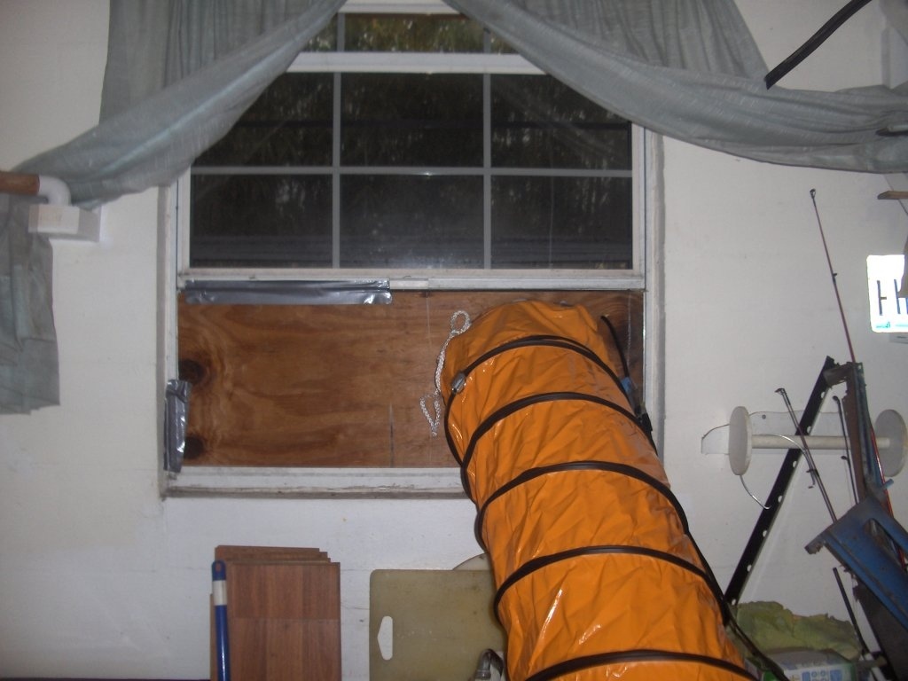

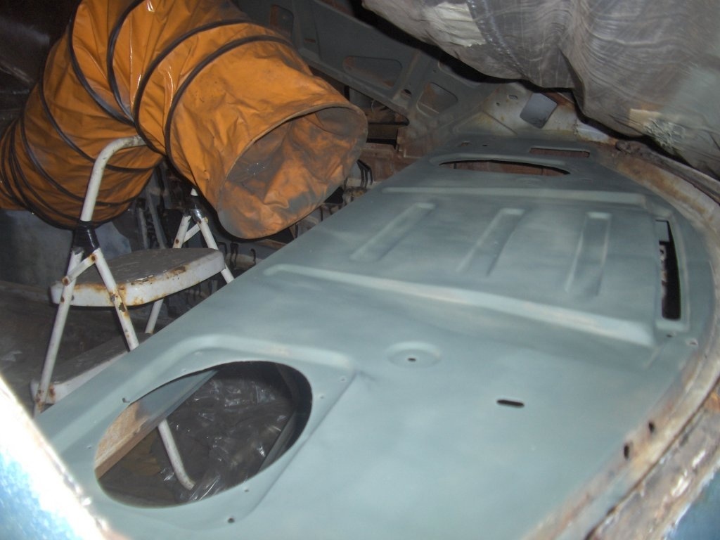

Again.....everyone is very welcome for the posting. My wife got me a 36 inch shop fan on wheels that swivels for fathers day. Worked great to blow the gases away from my work, and my lungs. I am praying that the crap filled sand in Iraq wont come back and kill me at a later date. I don't want to do myself in at this point by being lazy about safety.
I made this movable welding vent out of a 12" sewer ventilation tube and a 10 amp 1750 cfm fan. Sucks the fumes away.
