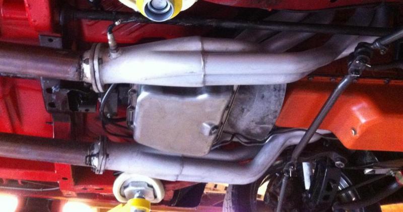

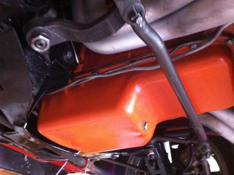

I think what you mean is the center link. It is drop forged steel, not just regular steel. welding will weaken it. A stock HEMI 6 quart pan clears the center link. See mine:
Also, altering steering components like this, aside from the dangers of a failure, affects bump steer: The tendency for the steering to deflect when going through its range of motion.

My pan looks exactly like yours pictured..I am wondering if there was a special center link to clear this pan?
Also I was not neccesarily wanting a pan that had the numbers stamped in them..just replying to a post that was not clear to me........ The car did not have an engine and the K member was for a 318. I used the Schumacker mounts. I don't even remember where I got my oil pan. ......................................MO
Do you have the original K member in the car? I wonder if either the K member is wrong or if the motor mount brackets are incorrect. The early B body positions the engine either further forward or rearward than a 66-72 K member. the odd thing is, the 66-72 K members fit the early cars even though they put the engine in a different spot. I'd think that this would possibly cause some interference.
