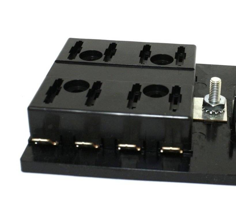

Bus bar is made if plastic kinda like a fuse box and it has holes molded in the plastic to be held down by screws. If I can find a picture of the one I purchased I will post it on here. Looked on summit racing and I can get a new ignition module. But for their asking price might as well buy whole new distributor.
Understand. Can only say, once you mount it, to the trunk floor, or wherever, use an ohmmeter, to check it. All depends on it's design. If you get any contact from either cable lug, to one of the mounting screws...you've got ground. Don't want that.
And, yeah...that's exactly why I don't use electronic ignition. Too many throw away parts.
This what it looks like.
OK, now I see what you are talking about. I thought you were talking about a buss bar like the style electricians use. That's a fuse block and should already be insulated by virtue of its construction. That is unless it's damaged or flawed. That particular block itself is not fused to main power so the fuse you mentioned earlier that blew was powering something. The question is, what was that particular fuse powering? That's where you want to start looking.
