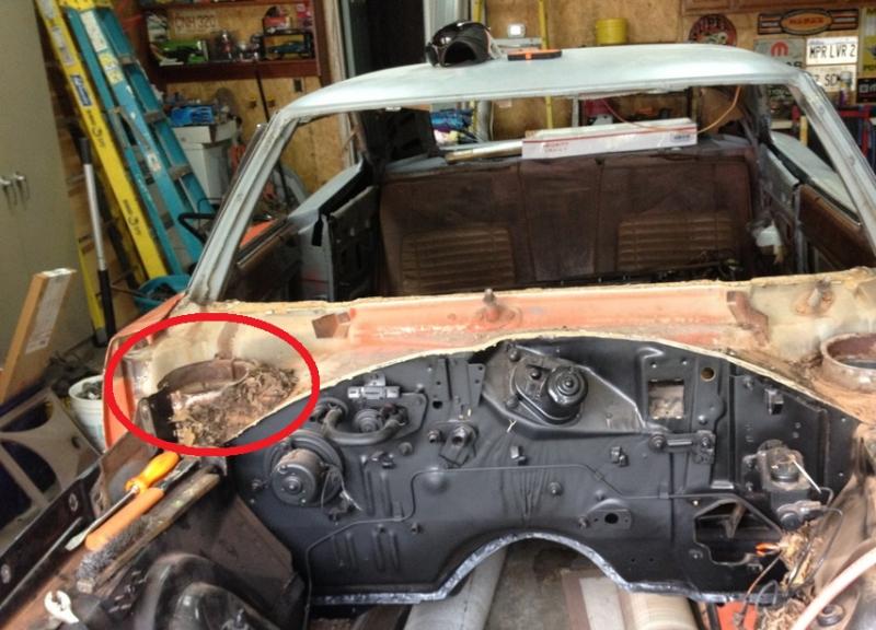

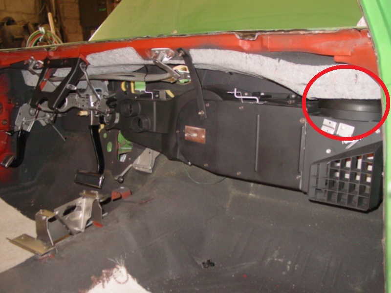

I have a small hole in the bottom of my wiper compartment? If it rains hard enough and the car sits, it'll drip down onto my feet. That being said My car is no wear near being restored...
Fresh air vents.
Leaves and debris traps moisture causing it to rust through on the outside.
