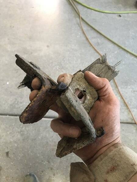

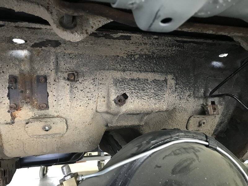

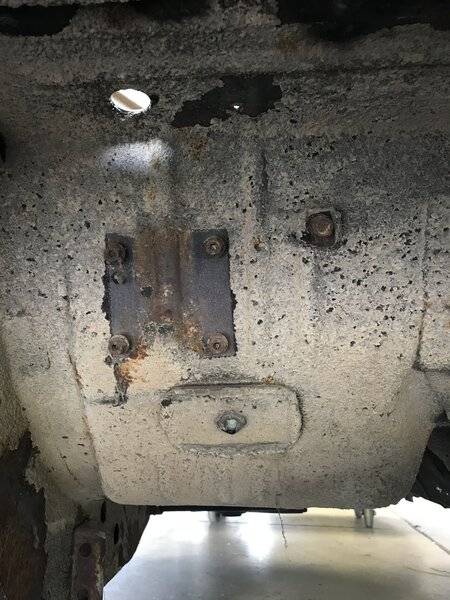

This is a 69 super bee. the driver side in front of the rear axle. Am I missing an exhaust hanger here?

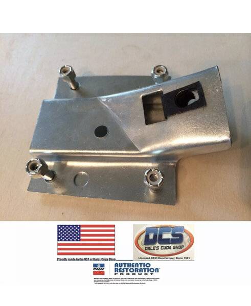

Yeah there should be a hanger that mounts to the 4 studs. Only came on cars with dual exhaust which obviously yours did.
