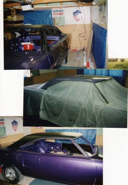

I had a good friend who is an auto-upholsterer by trade.
He uses Ados F2 from what I can remember....from a well-used spray gun.

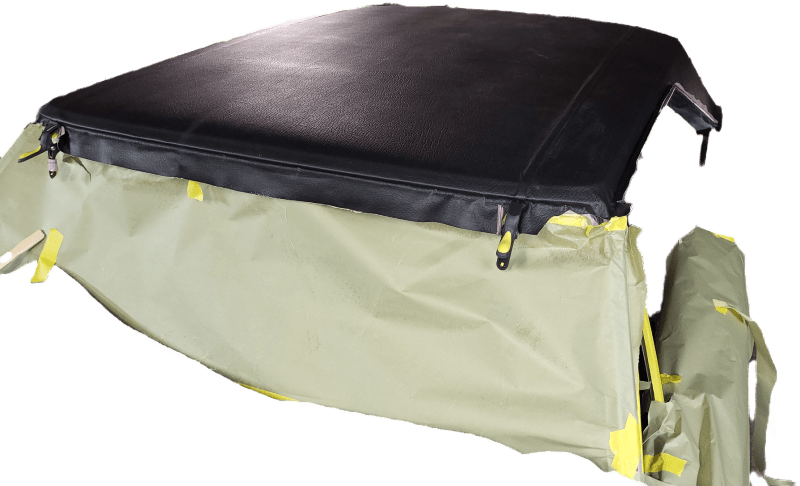

Chalk-line edges to get a rough cut for installation, masked up car with painters drop sheet plastic, and sprayed glue onto prepared roof - primer and 2K with tinter.
DAP High Heat Resistant Landau Top Adhesive
Amazon product ASIN B004IH3HAQ
First mask up the car thoroughly & tightly the better you mask the less you'll be cleaning later...
Find and mark the centerline side to side of your roof, fold your new top also side to side, backside exposed....
No glue yet... lay the top on roof, lining the fold point up with the marked centerline.. Shift the top front to rear to line up the A pillar covering....
Clamp the top in the window channel areas front & rear (you'll probably need to cut some material out of the rear window area) Then use a few more clamps to secure just one layer of the top to the side that won't be getting glued down at first....
Time for glue... spray a even coat over the exposed roof and the exposed backside of the top....
Leave the clamps that secure the single layer of the top but remove the first two which clamp both layers of the top...
Lay your hands flat on the top & pull toward the side of the car, done correctly the top just rolls onto most of the roof... You'll need to do some stretching especially at the rear but that rolling technique gets probably 80% of the install done quick & easy... I've never done one myself but I've watched a master do it dozens of times & that's exactly how he does it.... I haven't done it not because I can't but because my cars don't have roofs... So really I guess I can't....
