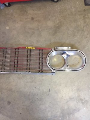

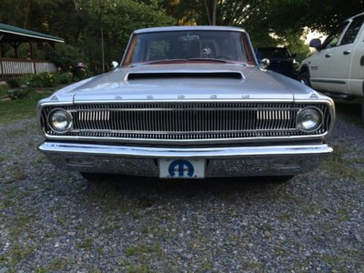

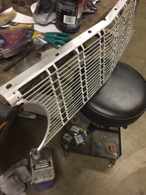

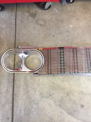

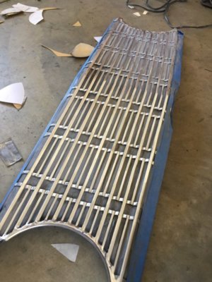

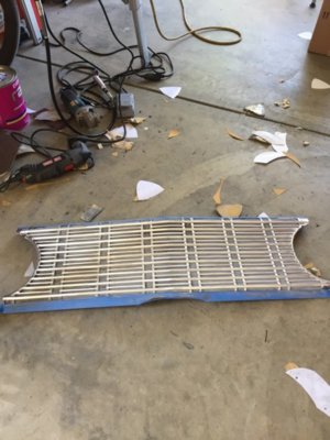

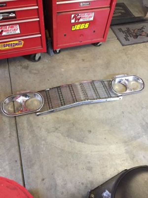

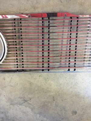

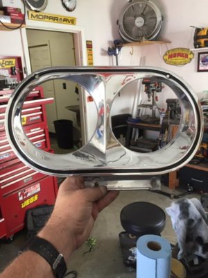

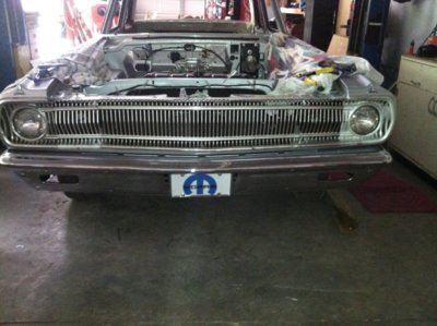

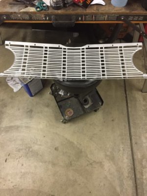

I did my own and then had C&J mopar trim strip polish it and reanodize it . You need 2 grill centers to make just the center. This is the mock up grill I made while trying to figure out how to do it. With a little time you can do it. The last picture is the final grill..
View attachment 607462 View attachment 607464
and too think you almost sold this car ?

5.7 does really work he did my rear bumper pan .. Yes KK I did almost sell it but thanks to you guys on here I’m proud of it
So many comments at the car shows right now,no headlight bezels and just a center grille:blah::blah::blah:
