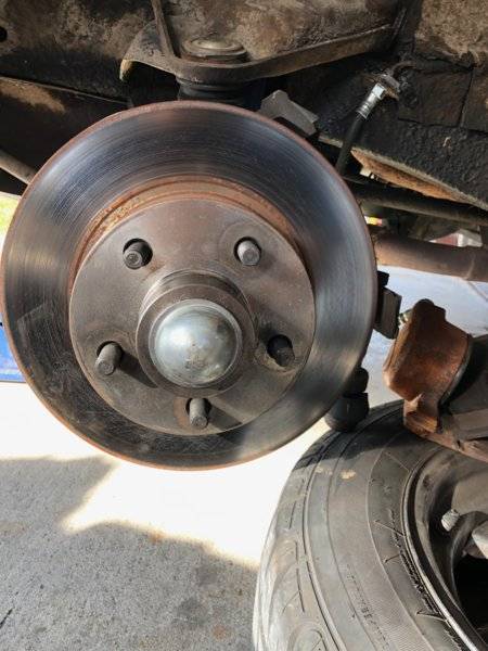

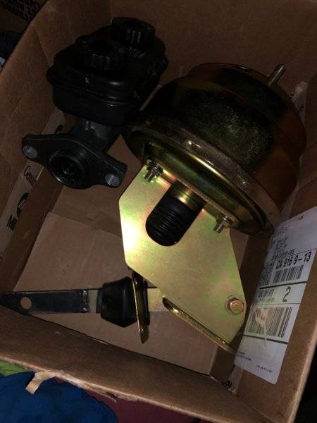

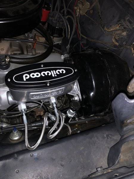

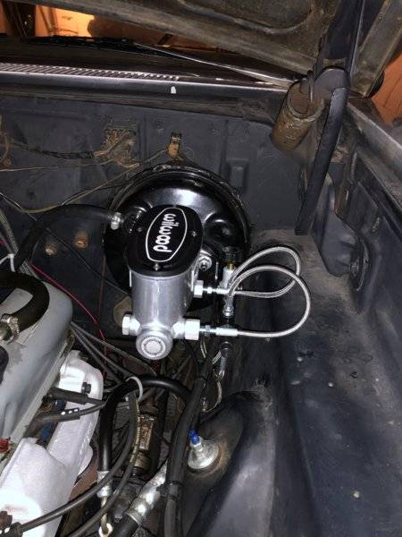

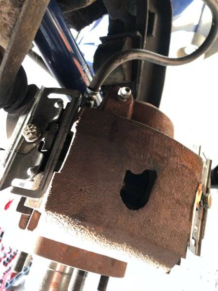

Been having nothing but issues with brakes on my '65 Satellite. All started when I bought the kit from CPP (Classic Performance Parts Placentia, CA). Installed the kit and come to realize, the booster doesn't work. Pedal was extremely hard. Went back several times for them to tell me nothing was wrong with anything and finally gave up with them and began with replacing the booster. Got a booster that was rebuilt at an experienced, reputable shop (Karp's Power Brakes in Upland, CA for anyone in SoCal I.E.). After the booster, the pedal felt normal but was sinking real low. Almost to the floor boards. Before that, the pedal was hard but didn't sink. The pedal travel seemed to have doubled. I thought while I'm at it with replacing the booster, might as well replace the master cylinder too. Got a Willwood with a 1 1/8 bore according to their tech line. Bled the M/C, then the lines at the wheels. The Pedal still sinks. And after all that, the car does not even stop well. While testing the brakes at about a 40 MPH "Panic Stop" the car travels about a length of 3 to 4 cars. Definitely not the "Stop-On-A-Dime" performance others tend to experience from the "Disc-O-Tec" swaps. The only thing I have left on the car from the CPP kit are the spindles, "slider" type calipers, and plain rotors. So what am I doing wrong, and what can I do to be able to drive with some piece of mind?
Any help GREATLY appreciated.
Booster And M/C with Willwood Adjustable proportion valve

Is the pushrod inserted into the master with the rubber,,,,,guess I'll call it grommet???Are you 4 wheel brakes??
No, no Rubber Grommet. Just pushrod from booster in master cylinder. Even got one of those PushRod tools to accurately set the gap.
Factory drums in rear.
The pushrod is supposed to be held in the master,if not there is a chance the pushrod can fall out of the master and jam leaving NO BRAKES!

Did you bench-bleed the Master cylinder prior to starting on anything else?
Petal feel or travel is in properly adjusted rear brakes. If the petal feels spongy reblead the brakes as air in the lines produces that feel. Bleed the brakes lines in this order: RR, LR, RF, LF. Hope this helps solve your problem. You mentioned a residual valve. If the new master cylinder has one you will need compatible rear wheel cylinders.
I re-bled this weekend, and pedal felt the same. There was no air in the system.
Okay. What's up front, disc or drum? If disc up front, next question is...is that MC made for disc/drum?
Last dumb question...are those flex lines off the MC???
Discs up Front, factory drums in rear. Yes, Willwood recommended i use that master cylinder when I called.
Yes, but I just changed those flex lines to hard lines.
