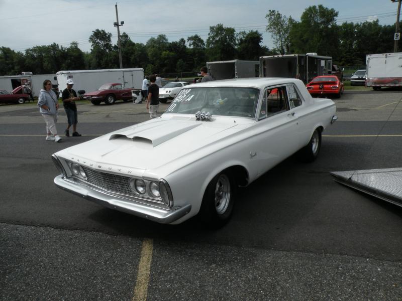

My 63 Plymouth has cheap front shocks and I think its hurting my 60 foot. I never should have went with 4.10's in my 63 but my ET and mph improvement was huge. I sacrificed my 60 foot, I just don't make enough power like the other 2 cars. I'm no way close to what this car should be 60 footing with a ladder bar setup.
