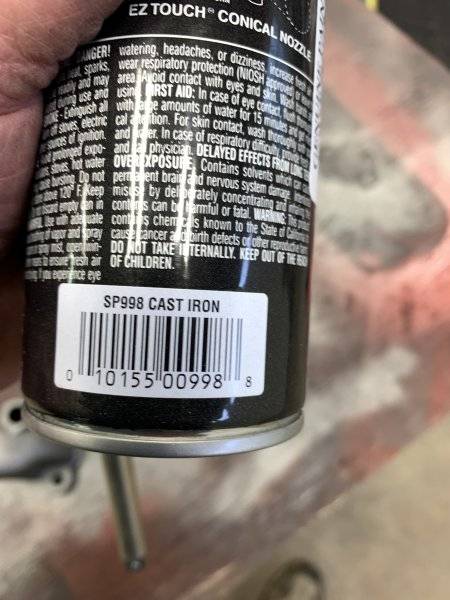

I used vht cast iron but it was around a year ago when I purchased it. Can’t remember if it was eBay or amazon.

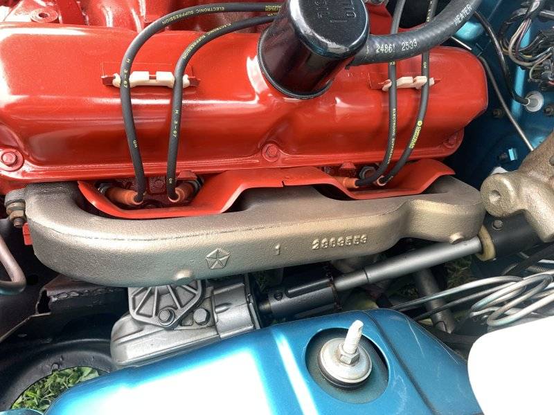

Here’s a pic with about 2000 miles on them. Some discoloring.
Can’t say what’s up with the right side manifold, maybe a surface prep issue. I cleaned these in the blast cabinet with a number 10 glass bead and cleaned post blast.
