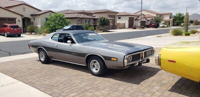

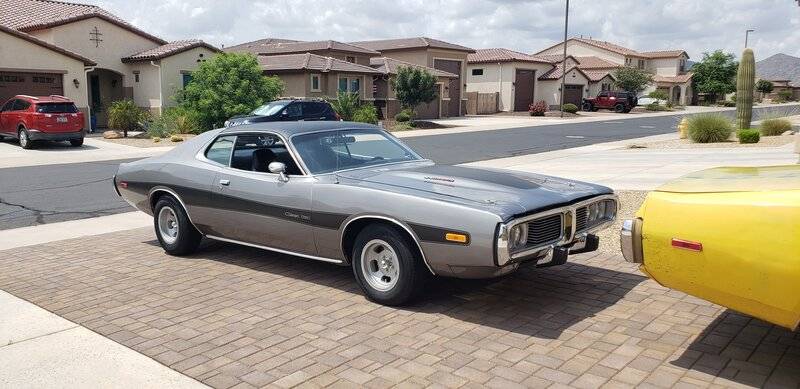

          Just to update. The job is done, rebuilt the trans, new main shaft, bearings, bell, and tail housing. New pinion on the diff, had a new drive shaft made. The car runs great. Trans shifts smooth. No vibrations.
