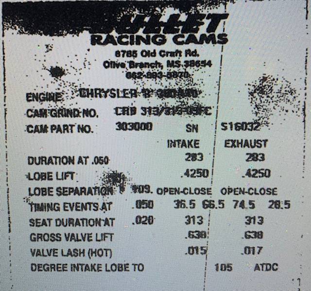

Buddy of mine has been running this cam for years... I'm blown away how streetable it is... Even does great with 3.23 gears...

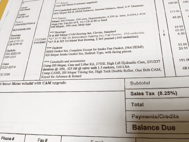

Old thread but I’m happy with this Comp build.
