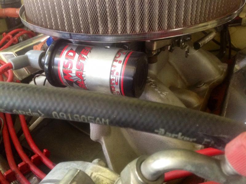

X2 to the msd blaster 2 coil, Just installed one on my 440 pretty much same as your build and runs great. I painted mine black to disguise it.

Just a FYI for those running -edit: oil filled- MSD coils. Per MSD tech dept. They instruct that their coils are to be mounted vertically. When mounted horizontal as in the picture above the windings are not fully covered by the oil inside the coil and this will cause the coil to overheat and loose output voltage and ultimately fail.
So far's I'm concerned, this coil mounting orientation is a cop out by manufacturers, nonsense. They SHOULD be made to operate in any position. Many of the old Ferds were mounted horizontally, and many of the old Chev six's were mounted INVERTED.
