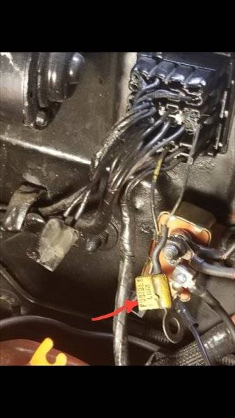

I will have to try this. Where is the fuseable link located?
Just to answer your question, a fuseable link looks like the one in your picture.
If that wire even goes there, it needs replaced by the looks of it. Its all frayed up at the bulkhead connection.
To test one, you use your ohms meter to see if current flows through it.

Well, I thought I found the problem, my two wires where they are crimped was touching each other on the starter. I moved them apart but still have the same problem. Do you think something like that could have toasted the starter relay?
I would think that might burn the fusible link before the relay. That's what the link is for. Just like a fuse, it will melt at a much lower temp. Just grab the fusible link and flex it. If it's good, it will feel like any other wire (some resistance), but if it has melted, all you have left is the insulation and will be very flexible.
