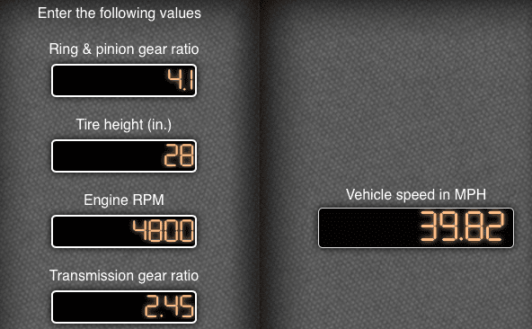

Assuming a 28" tall tire....
That's an awesome calculator! Oh yea, that's easily obtainable then. The cam is good to 6K+ and I have the rev limiter set to 6K. I'm sure the motor will sound awesome screaming through the open cutouts. :)
If your engine was only at 3800 rpm when trans engaged in low it would put a hell of stain on parts. Tires would force the issue, pop, boom. bang.
