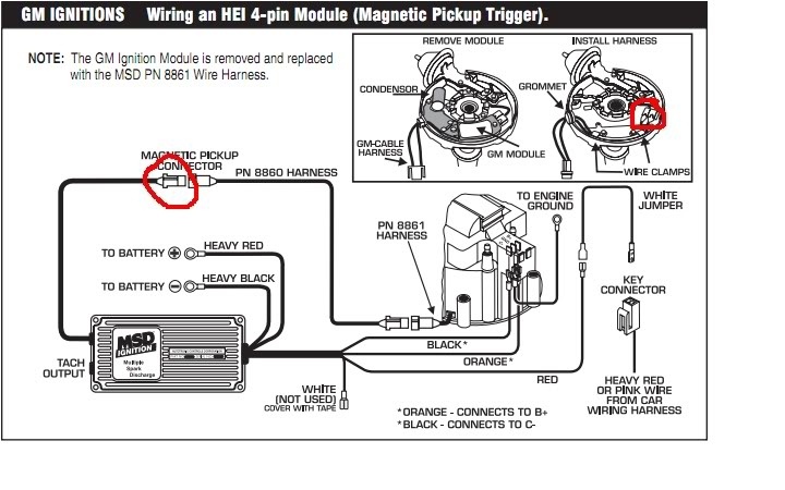

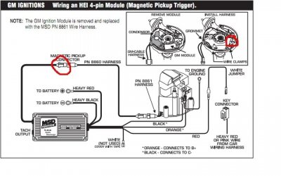

Don't know which box you have but if its a 6 series you can connect it to hei.
