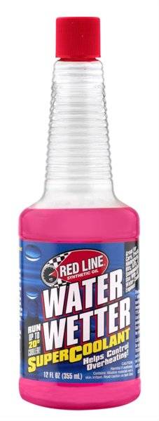

This stuff just plain works - BUT it should never be the only thing in there. Antifreeze must also be used in the proper mix as well.

That being said, the water wetter type chemicals aid cooling by increasing the coolants' ability to shed heat readily - but you still have to have a system capable of shedding said heat, namely surface area in your radiator (fins & rows) and airflow.
I use Water Wetter in my 442 and it has the anti corrosion additives and says antifreeze not required in warm climates. I just did a post about how this stuff works recently in a different thread: https://www.forbbodiesonly.com/moparforum/threads/wonder-fluid-or-snake-oil.153007/#post-910973958
This is true; the product does claim that on the packaging.
I ran it "straight" with distilled water for the latter part of last year and unfortunately, I did see evidence of corrosion in my all-new system, however.
This year, I'm running both a 50/50 mix and the water wetter. Temps remain same as last fall and I have known corrosion protection now.
