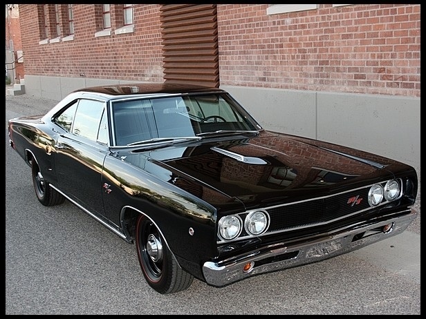

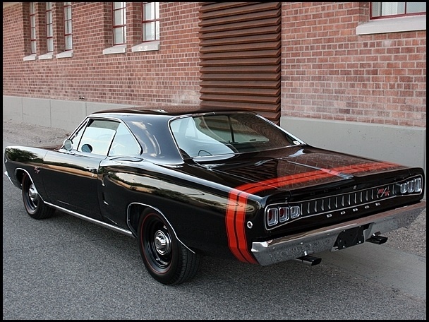

What do you think? Below is what I envision for the build to look like:

For you to make it look as nice as the Bee pictured above, you will have far more into it than it will ever be worth. However, if it is a clone that you want, get a nice used 383, or you can go with a 440. Both will cost pretty much the same money to build. However, I think that your estimate of getting 425 hp out of a 383 with only a carb manifold & aluminum heads is a bit optimistic.

The Coronet R/T you pictured most likely had a 440. You can buy a decent crate 440 from Indy or a fellow member here for a reasonable price.
If you go this route and make the car an R/T tribute that would be sweeet!
