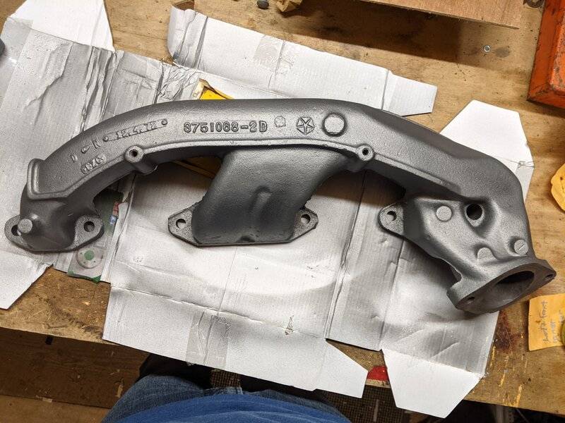

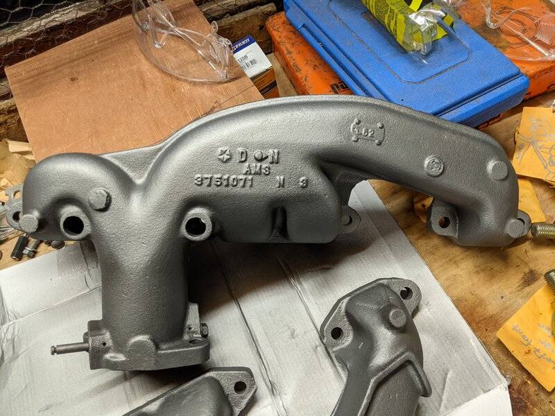

Here are pictures of the manifolds from a 73 Roadrunner with a 440HP
Thanks Mark and Trench. I think I have a lead on the 3751071 right side and am still looking for either the 3751068 or 3671595. With yall s help I now know what I'm looking for.
