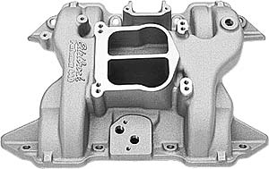

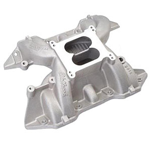

a dual plane will give you more low end torque. I am using a torker II single plane on my 440, it really starts to come on over 3,000 rpm, but I want something that will work better around 2,000 , so I am going to try one or both of these.
Edelbrock 7193
Edelbrock 2191
