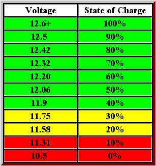

Now I'M confused. I always thought a fully charged battery was 12.6v (2.1v per cell).
